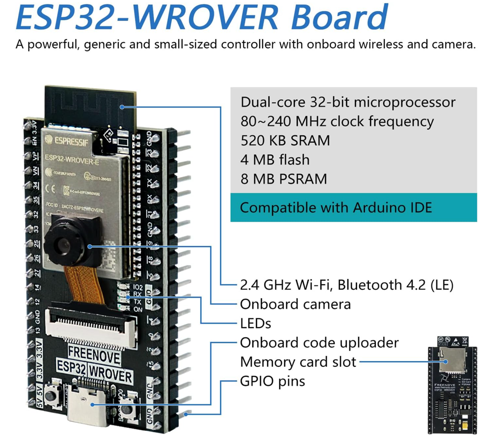

Well options are the best way to go with people who have different budgets. I tried to give multiple options on various parts throughout the build. The EZB is overkill for this platform but gives builders the ability to expand. The IO Tiny is a cheaper option to the EZB, but the pricing for the camera is soooo overpriced ($85), totaling $135 for cam and the Tiny. The ESP32 Cam comes in at about $9 (Amazon) $1 (AliExpress)for both cam and controller (I don't need Audio). Hard to compete if it works with 5 servos and can do a frame rate of 20 to 30 fps. I'll order an couple and do some tests.
