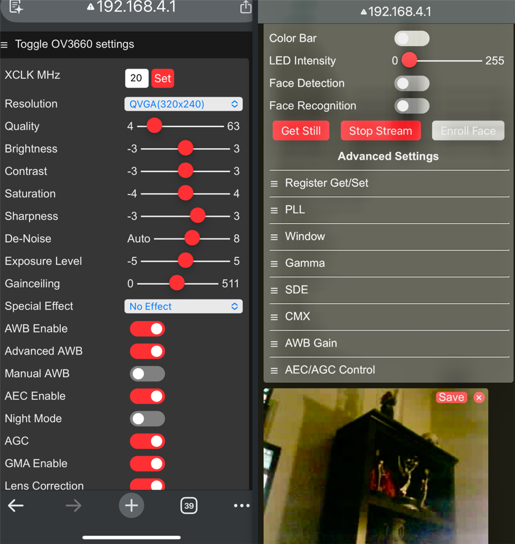

hahahha hippie code...yes this was me simply logging into the board with my iphone and turning on the camera..will try tomorrow with firmware!

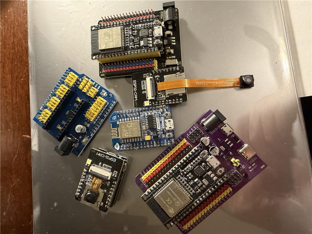

I played with dozens of these things in hopes to build a cheap robot controller.  The iotiny seems to work best but yeah it’s kind of expensive and hard to find.
if you end up putting together a cheap controller with camera I would love to see the solution.   I was trying to just build a cheap opensource robot connected to synthiam for kids at school. Idea was connect to AI and use camera, microphone, servos and led display based on Otto bot. but never found a cheap solution.  If you solve this would love to hear it. As you can see I tried a few esp and adapter boards as well

Yeah it probably could run 4 servos to walk, the cam to see, an ultrasonic sensor for distance with a Bluetooth speaker and microphone tied back to the host PC.
the ESP32 cam is pretty underpowered so you need to be careful with your code. Don’t try moving servos or reading sensors when using the camera etc.  I could probably go back and look at this again but I stopped volunteering with the young kids a few years ago.  These days I volunteer with First Robotics, these are high school kids building complex robots to compete in competitions.  You would actually enjoy this @DJ as they combine robotics and AI and compete at local universities in an arena. They have a global completion every year in the US.  https://firstroboticscanada.org/frc/
