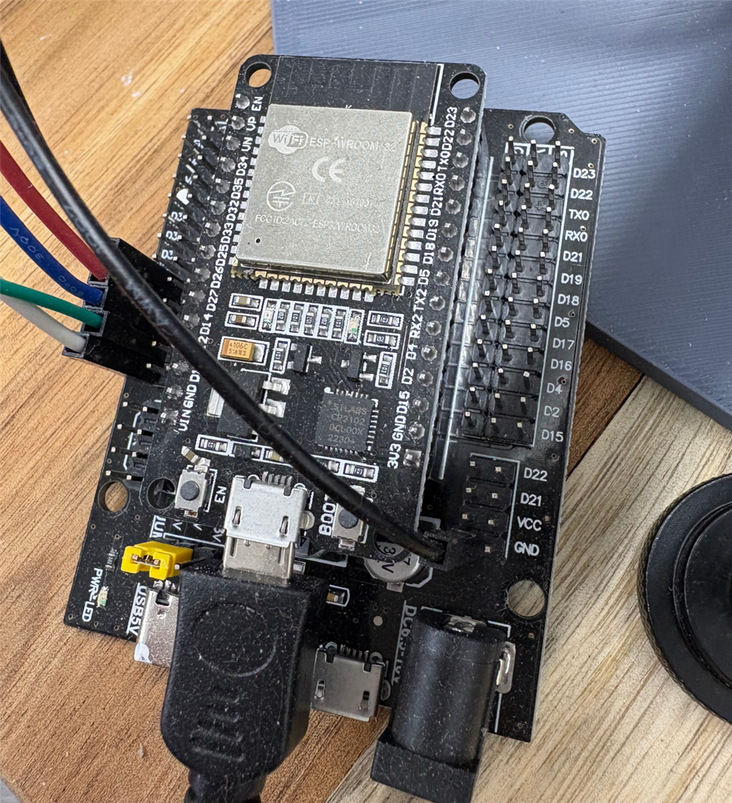

Here is the ESP 32 expansion board i got for my robot arm.

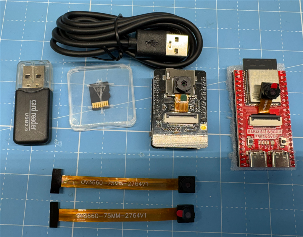

I got a few goodies in the mail today. Very curious to compare. Also the OV3660 cameras are supposed to be far more superior to the old cameras. Total cost for items in the image were less than $30.

Ok some initial tests today. Asking too much from the ESP32 CAM. Its so overwhelmed with the camera data via wi-fi, I get less than one frame a sec on the iphone tests, but def could be used as just a controller.
BUT, the Freenove ESP32-S3 Wrover shown above (red board), is extremely powerful and gives me 25 to 30 frames (via wifi) a sec at 320x240 plenty for motion detection/object detect. I found a breakout board that is a bit larger than the housed EZB specifically for this board. As DJ pointed out since it is all the ESP stuff is opensource, I found different boards with different pin spacings so they are not all plug and play.

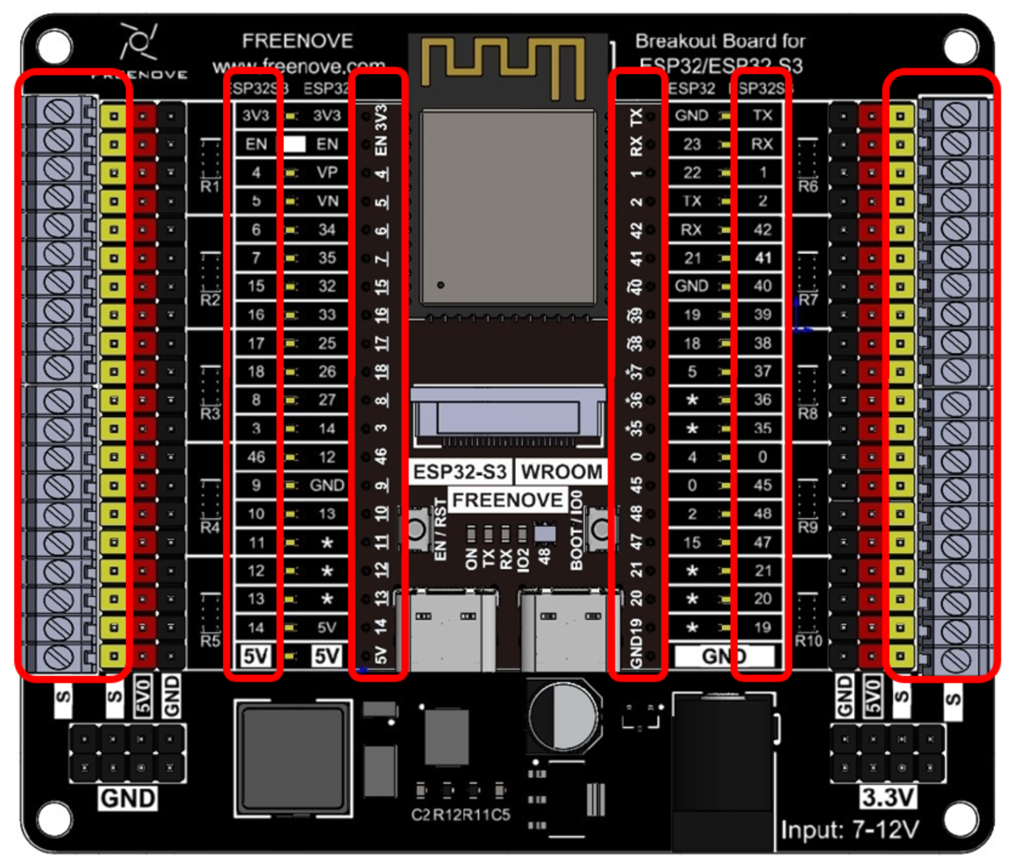

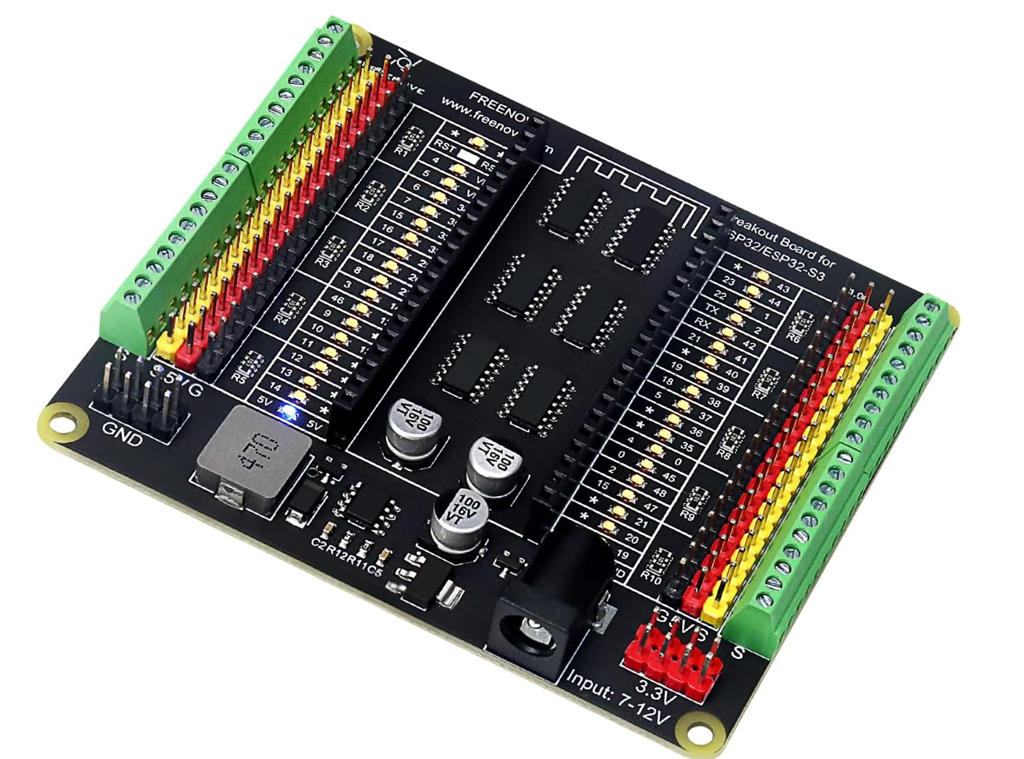

The Freenove ESP32 Wrover is a 40 pin board and the expansion board below is designed to work with it...its a bit big, 3.39 by 3.1 inches (cost $12.00) . I'm sure there smaller versions. So if I can get it all to work, it would be Expansion Board $12, cam $6, ESP32 $15 = $33
I'll take a look at the pin out mapping tomorrow.
Freenove Breakout Board for ESP32 / ESP32-S3 WROVER WROOM
