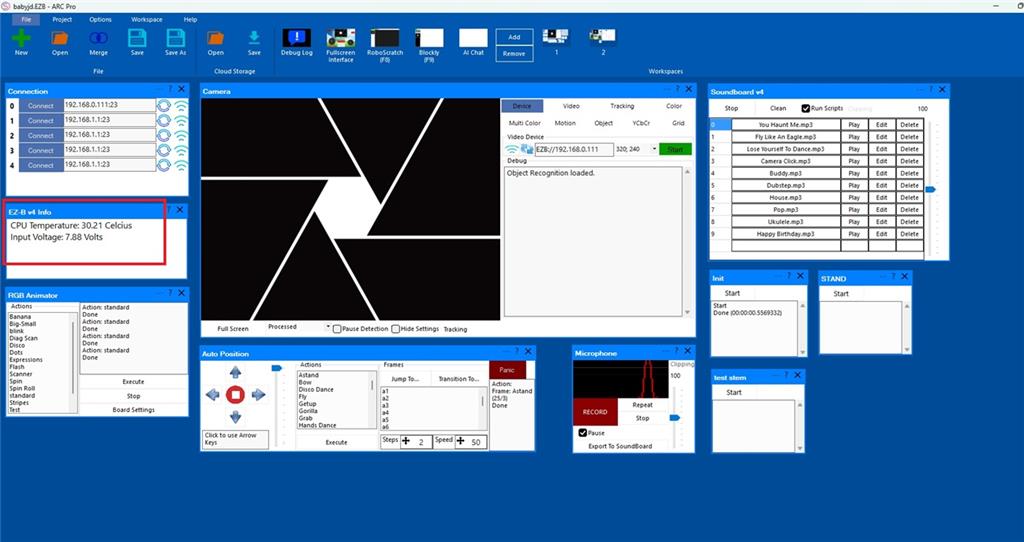

My EZBv4 disconnects immediately when I connect or enable the RGB LED. I already tried flipping the cable 180 but that didn't help.
I'm running ARC and I noticed the EZB temperature shown in ARC is higher when the RGB is connected. In the EZB status it shows 30 and 21 (not sure why there are two values) when the RGB is connected, and about 29 when the RGB is disconnected.

  • The "30 and 21" you’re seeing is likely two different readings in the status area, usually something like:
    • CPU temperature
    • Battery voltage
    If you want, I can help you identify exactly what those numbers are from the screenshot.
