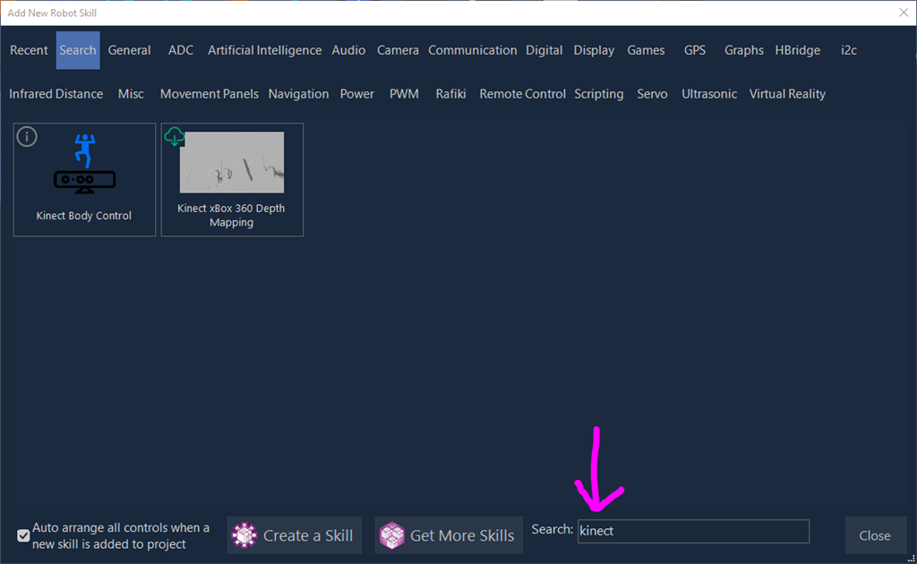

For Kinect sensors, use the Kinect robot skill.  You can also use the SEARCH feature in ARC's Add robot skill menu. You can type the words that you are looking for and it will search robot skills. Here is a screenshot

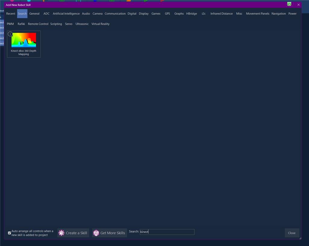

i am using the last version ff ARC.  click on project ,add then search kinect. it displays just Kinect Xbox 360 Depth Mapping, can't see kinect body control

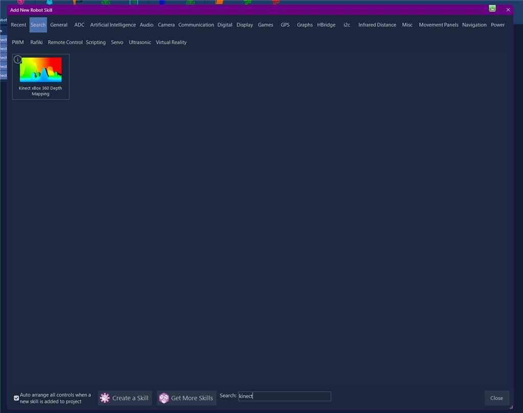

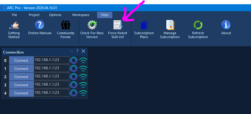

no luck. I forced the robot skill list,restarted ARC .Same behavior. I did again a force list, ARC closes automatically , reboot pc, start ARC, the same. I connected the kinect,i thought ,maybe the camera must be plugged, started ARC  ,no skill.
Great start! A reminder that an internet connection is required to download and synchronize files. To verify the progress of your download, view the DEBUG log by pressing the button on the top menubar of ARC. From there, you can see the progress and status of your robot skill synchronization. From your screenshot, it appears you are missing several robot skills.
This document is a reference: https://synthiam.com/Support/ARC-Overview/robot-skills/Syncing-and-Updating-Robot-Skills

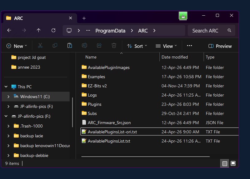

same problem, can't find the kinect body control skill. i did following: Ensure ARC is not running. Close ARC completely if it is open. Verify you have an active internet connection by opening a web page (for example, synthiam.com) in your web browser. Open File Explorer and navigate to C:\ProgramData\ARC. Delete the file named AvailablePluginsList.txt. Restart ARC.
ARC has created the new file AvailablePluginslist.txt at 11:26 am on the web page robot skill store, under camera, i see the kinect body control but why i don't see it in ARC ? i did again a force robot skill list.same problem I thought it might be hidden in another category. I looked through all the categories but found nothing.
I can see from your screenshot that ARC did refresh AvailablePluginsList.txt successfully, so the skill list cache is being rebuilt. Since Kinect Body Control appears on the website but not inside ARC, this usually points to one of these issues:
  1. The skill is not compatible with your current ARC build
  2. The skill is being filtered out because of the current search/category view
  3. The skill requires an additional dependency or is being excluded by ARC’s current plugin sync
  4. The skill listing on the website and ARC’s installed catalog are temporarily out of sync
