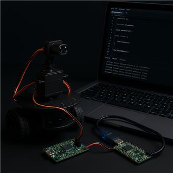

Hi @Athena,
Below are the files IR_TRACKERv4.1.ino, IR_TRACKERv4.1.h, and IR_TRACKERv4.1.cpp, plus the compilation warning I get when attempting to compile. Also included is the ARC UART script I use on the PC side (ARC Script robot skill + COM Connection Robot Skill).
For context: this is a Teensy 4.1 firmware sketch that uses Serial8 (TX8 = pin 35, RX8 = pin 34) to communicate over a PC COM port (e.g., COM3) with ARC. The Teensy is connected directly to the PC via USB serial (COM port), and ARC on the PC opens that COM port with a Script robot skill (not via an EZB). I’m asking two things:
  1. Can you rewrite the Teensy code to correct the compilation warning shown below?
  2. Can you make a v4.2 that cleans things up by splitting the parser into a dedicated packet handler and providing a proper ARC project setup (Script skill + COM Connection Robot Skill)? If possible, please include the Script skill code and a description of the ARC Robot Skills configuration.
