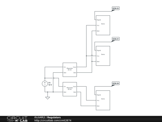

You can't bug me, I'll happily try to explain anything...
Basically, the simplest way is to buy a regulator such as this one. It comes with JST connectors on both ends, one male and the other female. I don't recall which way round it goes but will check when I get home.
This sits between the supply (up to about 25v I think) and the load (the servos).
It reduces the voltage down to 6v and can supply up to 5A. Enough for a few servos. Run more than one from the battery and split the circuits (of that's unclear say so and I'll knock up a quick schematic to explain it).
It's that easy.
You could make your own voltage regulator but I wouldn't bother.

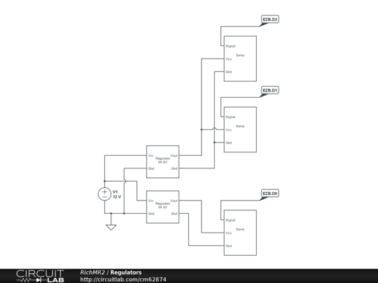

Decided to do a quick schematic for using more than one regulator here.
Or if it's legible
