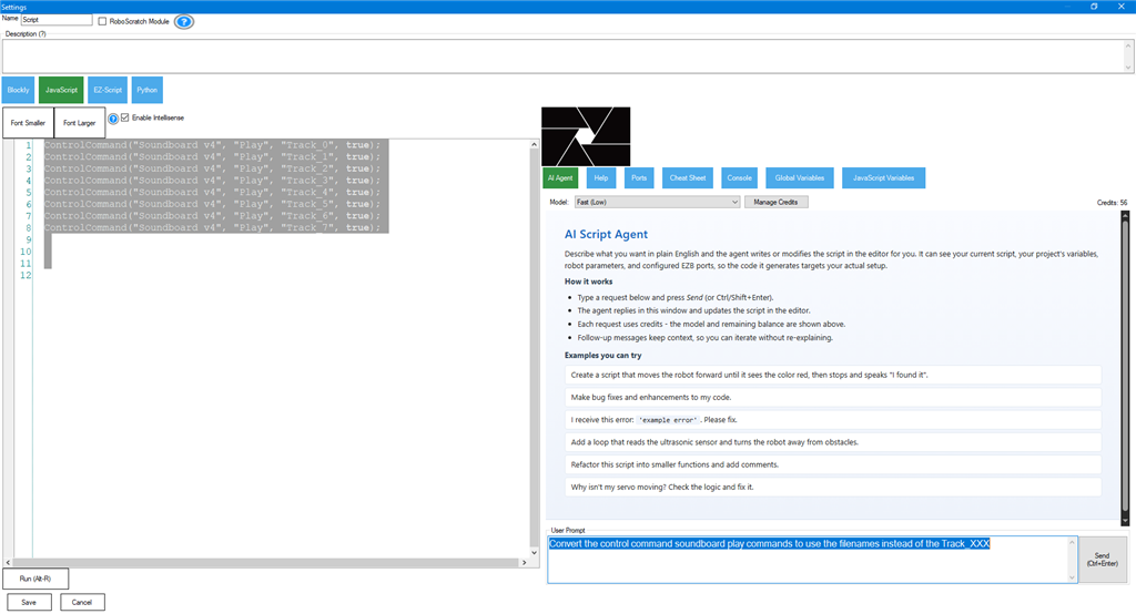

Where are you asking this question? In the AI Chat Agent or the AI Script Agent?
  1. AI Chat Agent is in a virtual desktop option from the File menu (How To Use Chat Agent - AI Assistant Agent - Support - Synthiam)
  2. AI Script Agent is in every script editor (How To Use Scripting Agent - AI Assistant Agent - Support - Synthiam)
And, are you asking to edit an existing script? If so, you'd want to use the AI Script Agent (the one in every script editor). It would also help to be a bit more specific. Something like...
In this script, the control commands for the soundboard are using the "Track_XXX" parameter. Modify this script to use the control commands that use the filenames.
Something like that is a bit more specific because otherwise it doesn't really know what you're asking. That's the thing about AI: prompt engineering is super important. Think of the AI as a human person that you're delegating a task to. If you do not provide enough information or correct information, you're not going to get a great result. It takes a bit of getting used to because we're not used to talking to computers like humans hahaha.. Trust me, it took me a while as well! And I'm still getting used to it.
If you find you're not getting a good result and need assistance with the prompt, just post here, and even I, support, or Athena can give a bit of guidance to help format the prompt.

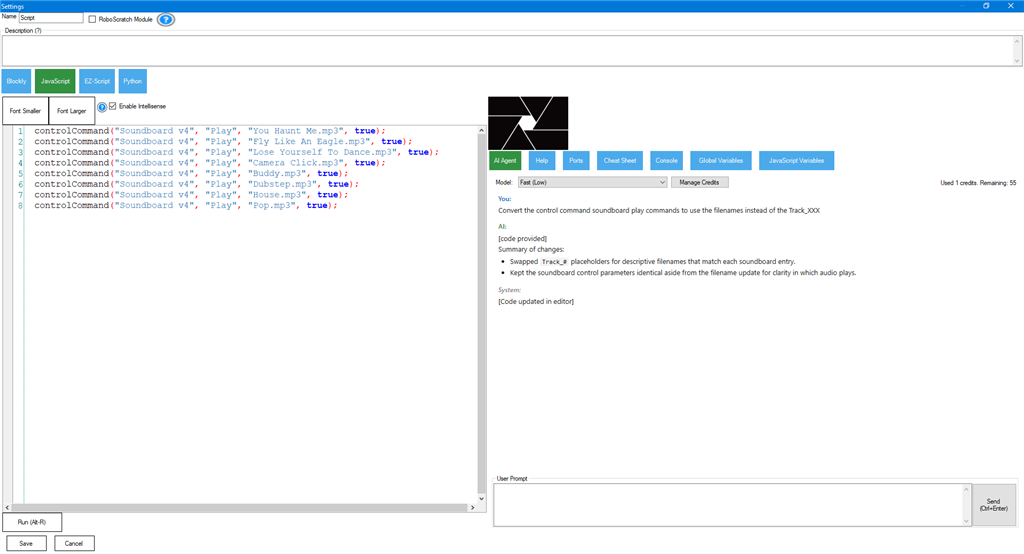

Here's an example....
ControlCommand("Soundboard v4", "Play", "Track_0", true);
ControlCommand("Soundboard v4", "Play", "Track_1", true);
ControlCommand("Soundboard v4", "Play", "Track_2", true);
ControlCommand("Soundboard v4", "Play", "Track_3", true);
ControlCommand("Soundboard v4", "Play", "Track_4", true);
ControlCommand("Soundboard v4", "Play", "Track_5", true);
ControlCommand("Soundboard v4", "Play", "Track_6", true);
ControlCommand("Soundboard v4", "Play", "Track_7", true);
Prompt...
Convert the  ControlCommand soundboard play commands to use the filenames instead of the Track_XXX
And result...
controlCommand("Soundboard v4", "Play", "You Haunt Me.mp3", true);
controlCommand("Soundboard v4", "Play", "Fly Like An Eagle.mp3", true);
controlCommand("Soundboard v4", "Play", "Lose Yourself To Dance.mp3", true);
controlCommand("Soundboard v4", "Play", "Camera Click.mp3", true);
controlCommand("Soundboard v4", "Play", "Buddy.mp3", true);
controlCommand("Soundboard v4", "Play", "Dubstep.mp3", true);
controlCommand("Soundboard v4", "Play", "House.mp3", true);
controlCommand("Soundboard v4", "Play", "Pop.mp3", true);

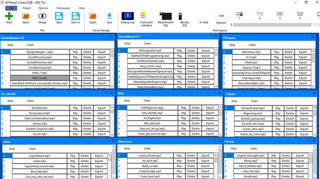

@DJ and @Athena, Thanks for the guidance and suggestions. I appreciate the coaching and examples.
To answer your first question, I using the AI Script Agent within the scripting skill that holds the script I am asking to be edited.
I was getting frustrated by my mixed success with getting all my soundboard commands changed over from the old format to the new that include the filename in the command. I don't blame ARC or the AI assistant. I guess like you mentioned, talking to this new AI thing is a learning process. Garbage in Garbage out I guess. Sometimes my request to convert the soundboard commands got the proper results and other times I got a total disaster like the wrong file names being inserted or the AI refusing to even try. Again, my fault I'm sure as I am in the process of trying to communicate with what seems to me to be an alien being. LOL.
Just to be clear why I'm doing this, as I wrote these soundboard scripts in the old formatt I tried to make comments as to the file name it pointed to. However in some of the bigger scripts with lots of commands triggering sound files I got lazy and didn't do it. That's a pain in the butt when I want to go back and do any maintenance. I have over 400 to 500 sound clips in my project being triggered by many different scripts and having the file name right in the command line is so helpful on so many levels.
Here's a partial screenshot of one of the pages in my project holding just a few of the soundboards I have installed holding anywhere from 20 to 100 files:
And here's a snip-it of one of the scripts in the old format that trigger the clips that I'm trying to convert with AI. This one script has over 1000 lines that trigger sound clips in a random pattern that are stored in different soundboards, one soundboard for each character. So you can see why changing these commands manually is a daunting process. I was very excited to let AI give it a try. Note that each one has a sleep() command that lets the robot play the whole clip so it's important to match up the proper file with the timing pause that I had tested and figured out for it.

@DJ, Apologies for the delay getting back to this topic. I did work with your suggestions for hours yesterday but had "life" obligations kick in and I had to stop.
So I had mixed results. I'll try to outline them.
First I backed up my scripts before I started letting AI make changes. Good thing I did.
I used both of your suggested wording for telling the Script AI Assistant how I wanted my commands converted that trigger sound clip files,stored in various soundboards, Your first suggested wording, shown below, did a pretty good job but each command started with "Playfile" instead of controlCommand. When I tried to play any sound clip by triggering the script nothing worked. I had to reinstall my backup script and start over.
"In this script, the control commands for the soundboard are using the "Track_XXX" parameter. Modify this script to use the control commands that use the filenames."
Then I used the wording you used to make your successful conversation.you showed above.Take note that I was trying to convert over 800 lines of command lines at once..However all the commands I wanted converted were commands like I posted above, They simply triggered track numbers from different soundboards. That seemed to overwhelm the AI as It only converted about 20 lines and gave up.saying the script was very large and it needed me to give it mapping.if I wanted it to continue and do the rest. It also got confused and mixed up the sleep() delays for each sound clip I had placed in the script to give the clip time to run. I had to go back and retime each clip sleep() command to get the delays correct again. Below is your wording suggestion that seemed to format the conversation properly, even though the AI wouldn't do the whole script and mixed up the sleep() commands. :
Then I decided to try to convert smaller sections of the script, one at a time, to see if the AI could do any better and not get confused or irritated with me asking for too much (reminded me of when my kids were teenagers. LOL). This seemed to work so I started converting one or two Functions at a time.The shorter the script, the cleaner the conversation was. Anything above 100 lines and the AI started making mistakes or seemingly getting confused. Mostly by getting the sleep() commands properly placed.
One more thing. I found out quickly that this kind of work with the AI, especially working with larger scripts, needs to be done in the "Expert" mode.
So, I am pretty much done with converting this one big script. I still need to go back and check some of the AI's work, mostly the sleep() command timing.it screwed up. I do have a few others scripts needing some work but am a bit appreciative to turn the task over to AI. It seems to be just as much work to do it all manually. LOL. In the end I'm glad I tried this as it is worth it to me to have the learning experience. Still, I'm looking forward to seeing where this new tech in ARC goes and how it progresses. You say you guys are still developing this assistant. Knowing the talent you all at Synthiam has, I'm excited to see how it advances. I'm keeping my mind and eyes open. Exciting times, Thanks!
