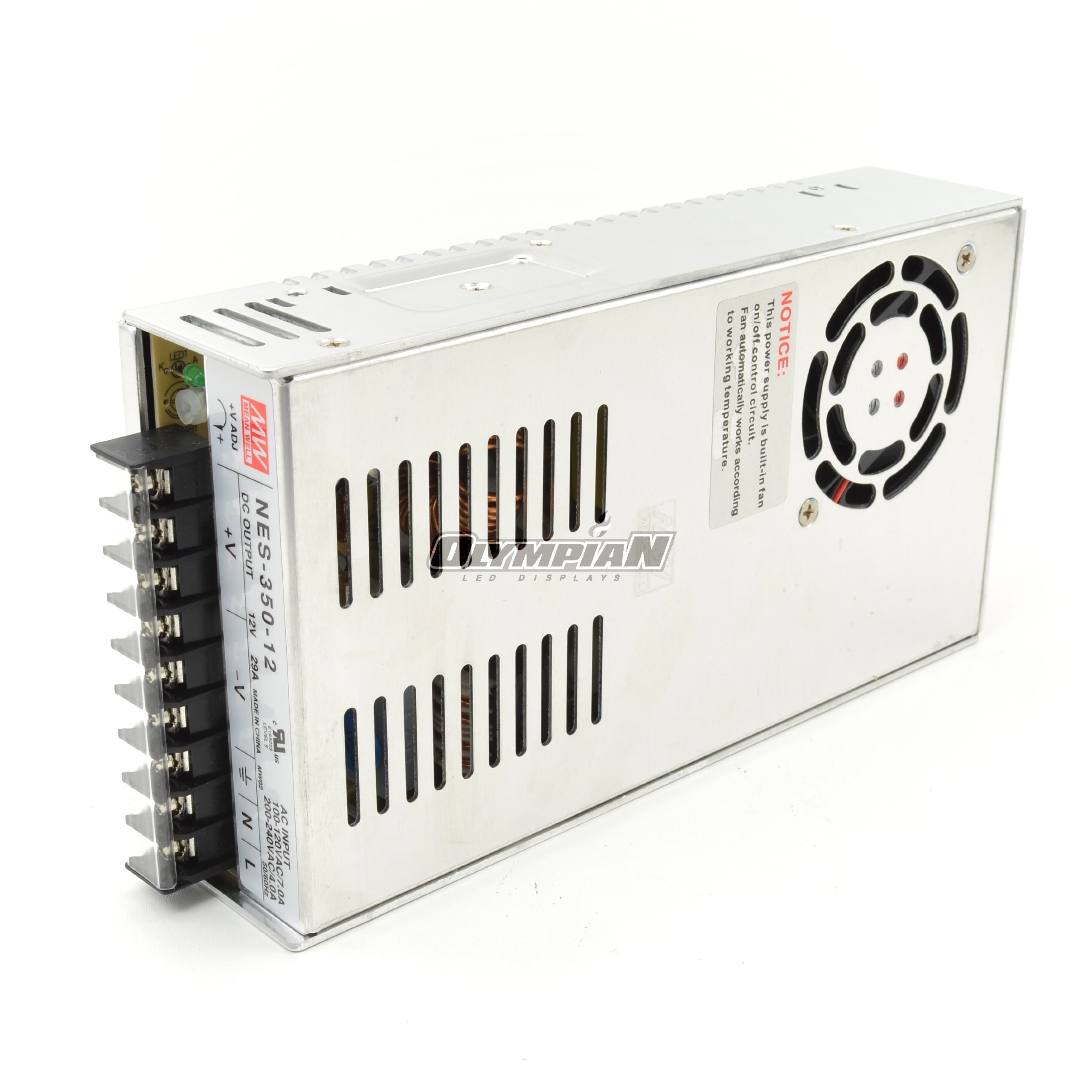

I also am using a 30 amp Mean Well power supply for my arm DC motor and servos (one DC motor and 4 servos). It cost $55 USD:
Meanwell 12 Volt 350 Watt Ul Switching Power Supply 120 Volt Input Constant
