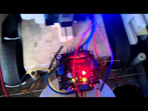

This is bugging the hell out of me...I have a L298N H bridge setup and for the life of me cant seem to figure out why Megabyte turns to the right . Instead of reversing straight back! Ive tried swapping all the combos for movement in ARC. Forward, left and right work. But reverse he seems to pull to one side. Im sure its something obvious,...but im stumped!

EnA and EbB are wired togther with a y cable . They run to D0 for PWM. IN1,IN2,IN3,IN4 run to D16,D17,D18,D19.

@ Rich this is the board im using. Will it make any difference when trying to trouble shoot? The motors turn and i can see the lights on the bridge come up. But i still cant get it to reverse. If i do get it to reverse it wont move forward. Tried swapping jumpers and there good
