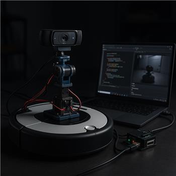

I’m running an iRobot Roomba base in ARC, connected over USBTTL serial (COM4, 115200) using the iRobot Roomba Movement Panel. On top I have a 2DOF pan/tilt camera on an EZB v4 (D0/D1) and a Logitech C920 USB camera into the Windows laptop that runs ARC. I added the Single Camera servo Server skill so a Unity client can get the video and send servo positions.
Unity connects to the skill on localhost (using the port shown in the skill UI), video streams fine, and I’m sending two "virtual" servo channels (D2 = turn, D3 = throttle). In ARC I map those to the Movement Panel with a small JavaScript loop (below). It works, but two issues are blocking me:
  • If I pause/disable the Camera Device in ARC, servo updates from Unity stop completely, so I can’t drive without video.
  • When camera FPS dips (e.g., 320x240@15fps dropping to ~8-10fps under load), Roomba driving becomes bursty and lurches, as if servo updates are throttled to the camera frame rate.

I tried lowering camera resolution/FPS, moving the camera to another USB bus, and running Unity on a separate PC; the jitter still correlates to camera FPS. Is there a way to decouple servo transmission from the camera stream in Single Camera servo Server (or keep servo updates alive when the camera is paused), or should I use a different ARC skill/protocol for reliable Unity-to-Roomba driving?
