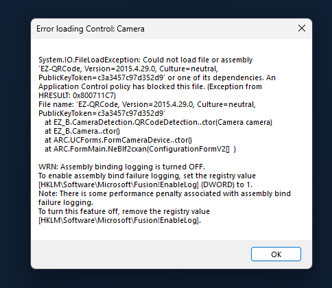

I'm getting this error when loading my ARC project at startup - please help. What does it mean? Is this a camera-control issue, a robot skill issue (for example, a camera/vision Robot Skill), or an EZB/hardware connection problem? My camera is connected directly to the PC via USB (not through an EZB), so I'm not sure which part of ARC or the hardware stack is causing the error.
Attached screenshot of the error: image.png
Let me know what additional details would be helpful (ARC version, list of Robot Skills in the project, EZB presence/firmware, Windows device name for the camera, etc.).

From the screenshot, this looks much more like a camera / vision robot skill startup issue than an EZB firmware or robot-controller connection problem.
What it usually means
When ARC loads a project at startup, it tries to restore every robot skill in the project. If a camera-related skill is configured to use a USB camera that:
  • isn’t available yet at startup,
  • is already in use by another app,
  • has changed device index/name,
  • or was removed / unplugged,
then ARC can show a project load error.

- installation is corrupt (uninstall, remove folder, reinstall with a new download from the website) - the dll is blocked as the message says, so maybe it's blocked because you accidentally added it to a virus scanner or windows defender
The message states that the file is blocked for some reason. Try a complete uninstall and that hopefully will help.
If that fails you can try a big fix: https://synthiam.com/Support/troubleshooting/Completely-Remove-All-ARC
That message is pointing to a blocked or corrupted ARC installation component, not a camera-specific problem.
What it means
If ARC says a DLL is blocked, that usually means one of these:
  • Windows Defender / antivirus quarantined or blocked the file
  • The ARC install became corrupted
  • A plugin/robot skill DLL was not installed cleanly
  • The file was marked as coming from the internet and blocked by Windows
Since your camera is USB direct to the PC, this is still not an EZB firmware issue. It’s more likely an ARC installation / robot skill library issue.
