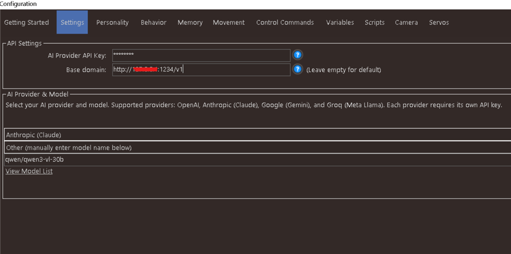

  • In my ARC project, the Autonomous AI robot skill is configured to use the Anthropic option.
  • I set the skill's Base Domain to: http://0.0.0.0:1234/v1

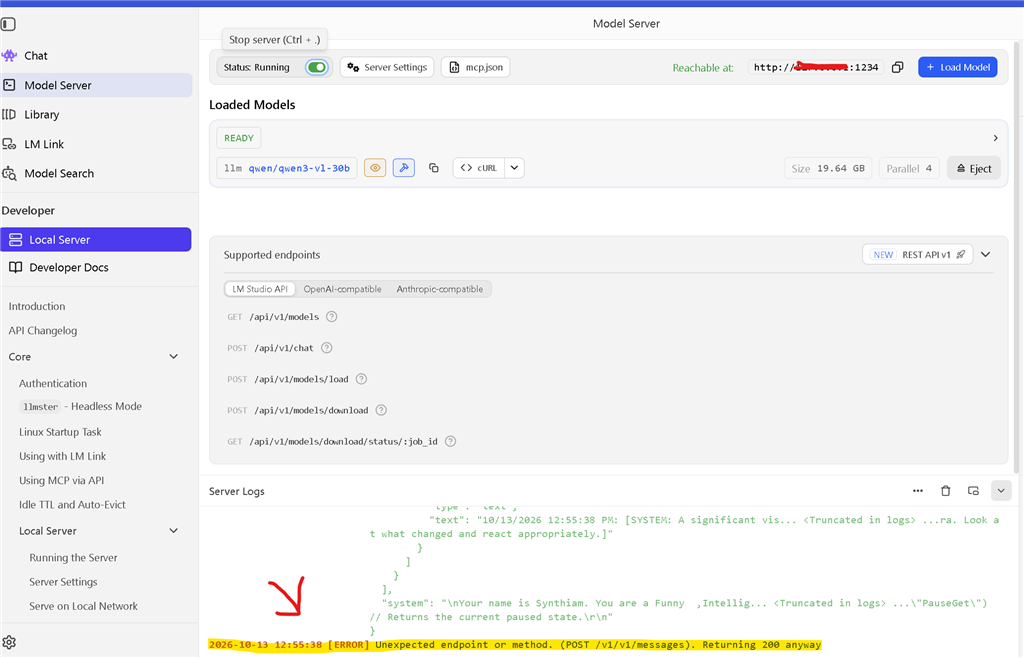

  • When I send a message from ARC, LM Studio reports this error: "unexpected endpoint or method. (post /v1/v1/messages)".
From what I can tell, the skill is appending /v1 to the Base Domain, causing LM Studio to receive /v1/v1/messages instead of /v1/messages. ARC is connecting to LM Studio over the network (this is not hardware connected through an EZB).
Question: If my diagnosis is correct, can the Autonomous AI robot skill be modified so it does not require a trailing /v1 on the Base Domain (or otherwise avoids duplicating /v1)? Any guidance or ideas would be greatly appreciated. Thanks!

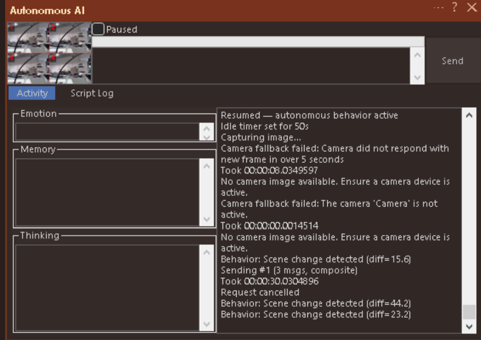

Your diagnosis is correct: the skill appends /v1/messages itself, so the Base Domain should be http://127.0.0.1:1234 (or the LM Studio PC's LAN IP). When the path is correct, LM Studio actually runs the model, and Qwen3 VL 30B processing an image probably takes longer than the skill's current 30-second request timeout. That shows up as "Request canceled" in the skill log.
Could you confirm what the skill's log shows after removing /v1, and whether LM Studio's server log shows the request arriving and being generated? We're raising the timeout in the next update. Meanwhile, you can also try the OpenAI provider option with the same base URL, since LM Studio's OpenAI-compatible endpoint is the most complete.
Ok, so removing /v1 from the IP address allows LmStudio to receive messages without error now with both anthropic and open ai settings. You are correct that ARC is timing out before LM Studio has time to respond. ARC log attached: v1 removed.png yes probably need much longer than 30 seconds lol. Looking forward to the update!
