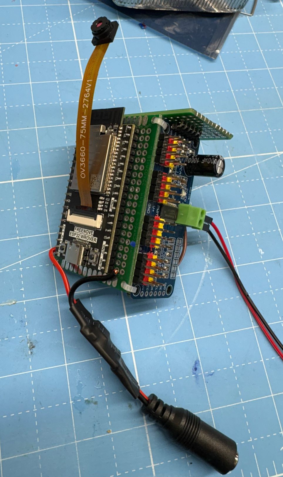

Well here is my quick bootleg EZB ...(Maybe EZBootleg_CAM_16):D Its mocked up to sit vertically in the shoulders of the Mecha Morphix. Cost <$30 for ESP32 CAM, servo Controller and camera.
Twitter
#162
Nice you may want to throw some power management on this. I have already taken out an ESP and a PCA board with a 2S LIPO connected to 16 EZ-Robot HDD servos.  (Stuck it in a JD robot). Now out of PCA controllers on order on a slow boat from China.
#163

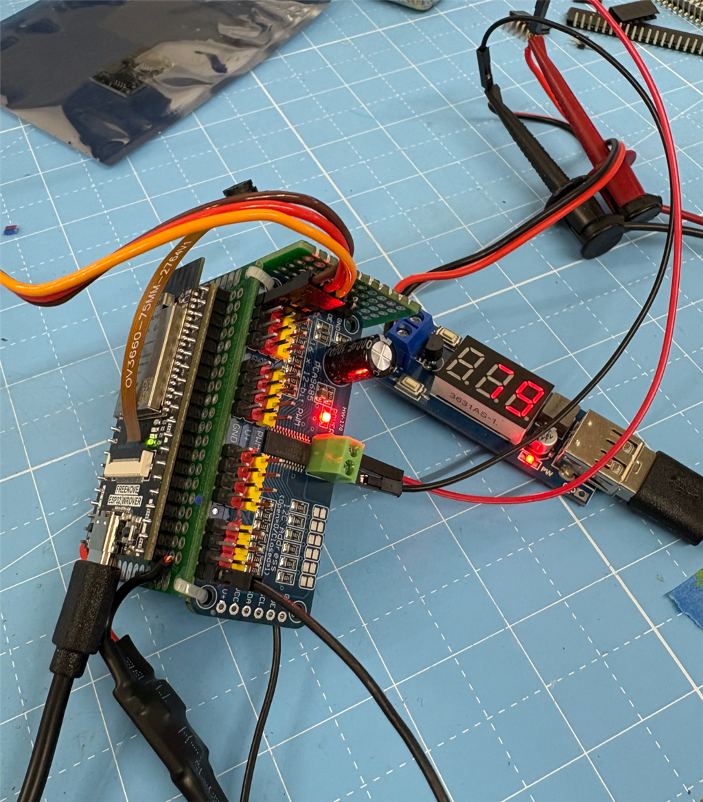

I've not had any issues with power, i have a buck to 5v in the pigtail, and a bench  power supply for servos. But I am having this issue just now starting it for first time.
@Athena what can be the cause of this issue?.It connects fine to the ESP and camera works fine. But if i move a slider to move a servo it kicks the connection without moving servo.
Connected
TCP Comm Error: Unable to write data to the transport connection: An existing connection was forcibly closed by the remote host.
Sent: 172 113
Bytes Expected: 0
Received (0 bytes):
Disconnected
Attempting connection on 192.168.1.1:23
Connected to 192.168.1.1:23 (tx timeout: 2000, rx timeout: 2000, tx buffer: 20000 rx buffer: 20000)
Reports CapabilityController
Capability controller reported firmwareId: 0x12
Firmware 'DJs ESP32 Cam with PCA9685' (0x12) on 'PCA9685 I2C 16 Channel servo Shield' supports the following capabilities:
 - Read/Write Digital I/O Ports
 - Hardware UART TX/RX with DMA buffer and adjustable baud rate
 - PWM Duty on digital ports
 - PWM servos on digital ports
 - PWM servos on digital ports can release their position
 - Native WiFi Connectivity from ARC
 - Can stream video v4 codec
Connected
Sent: 172 126
Bytes Expected: 0
Received (0 bytes):
Disconnected

Well interesting. The tiny buck converter is causing some issues. If I off load it and replace it with a battery pack and plug into the usbc port on the ESP32 it works fine. Only when I plug into the bench power supply do I get failure. Maybe I soldered the 5v buck and barrel jack to the wrong place on the ESP32? I'll see check.
#166   — Edited
ok more testing and narrowed it down to the buck converter..so i connected up another one (7.5v to 5v 3 amp) to the USBC connector and all works well. I will say as I was messing around I have noticed that  ARC drops connection (i.e computer remains connected the ESP32 in network). I have to click on 'connect" to regain connection. Have to see how often this happens.
#167
