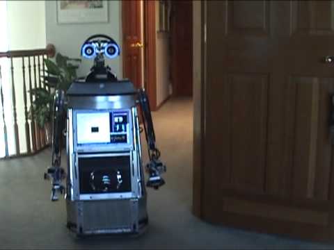

Mp3 triggers, wireless speakers , walkie Talkies - I'm looking for the best way to get Bob to speak, play music , make noises etc. The more threads I read on this subject the more I start scratching my head as to which way to go.

Thats awesome that you can do that. I saw this video of an incredible DIY robot that roams around the house from voice commands to it in the room (or so it appears). It doesn't speak back - which is what this thread was asking about - but there is a PC mobile robot called Sparky that speaks and can be spoken to for contact with family when your away (a bit like skype) on wheels. I'm thinking a low cost pc 7 inch tablet on the chest of Bob could act as both a listening device and a speaker (earphone jack to small amplifier). My wife said she would get me one for my birthday but it's android based. I was wondering if the EZ-B be run from an android tablet yet ? If not should I just get a small windows laptop (around the same price $200) or forget the whole idea and stick with the walkie talkie.
In the mean time, check this out - you may have seen it but its amazing

Thanks - I'll take the plunge, I think I can overcome the feedback DJ as Bobs a larger class robot , it will be great experimentation - so should I go for a 7 inch MS windows laptop or could an Android Touch pad do the trick ?

Update: Unless I'm missing something, MS windows is currently the best environment to run the ARC. I'm starting the hunt for a light, small inexpensive netbook with camera, earphone and microphone jacks, blutooth and wifi running windows. Provided it is not too wide I can accommodate Bobs torso to fit the netbook to angle out from his chest (sloping forward) with a portable cover.
