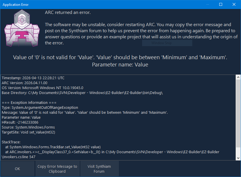

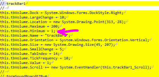

There's never been a volume 0 in the soundboard ezb.
Looking in SVN, the soundboard was first introduced on Tuesday, November 5, 2013 @ 12:03:32 AM Mountain time
The volume was added the same morning November 5, 2013 3:24:05 AM Mountain time and the min volume value has been 1 every since. Looks like i had late night! I'm not fully sure how volume 0 would work or what it would do but you can try it with Athena's suggestion.
Ha yup i see now what happens if you set the volume to 0 lol
