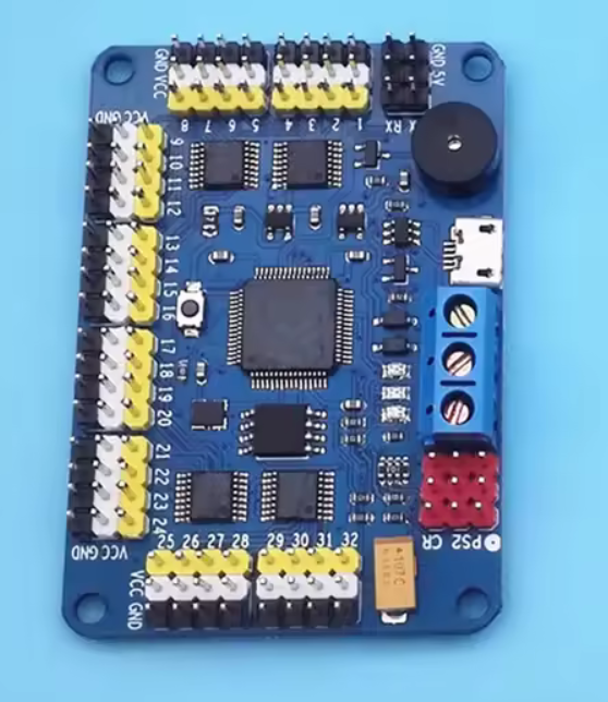

Athough i do see it happen with the servo pad vs horizontal servo control. looks like the two tasks running on each core can't keep up. maybe yeilding the task while transmitting the uart or something might help. the esp32 is such a peice of #\(#\)@
#197   — Edited
Sorry fellas was away for dinner.
Yeah I noticed the same thing with the slider vs servo pad. Yeah sorry the ESP32 is a piece of do-do. But its incredible what you've done in such a short time with the ESP32 series of boards. This was a big ask with the SSC32 as it would create a wireless Mega EZB..lol. I can still do the ole ESP32 camera separate and another ESP32 connected to the SSC32, if i can make room.
EDIT: the libraries strikes again, i checked against my compile and using the wrong version ESPressif ...updating now.
EDIT #2 updated libraries and it actually seems to shudder more on the servo but a bit better on the camera frame rate.. Maybe Lynxmotion needs to update the SSC32. This card is 9 years old. A faster baud rate would help. I'll look and see if Ali express has something more upto date based on the SSC32.
#198
..ok there are several faster chips sets but the baud rate remains the same 115200 max. And the prices starts to go up too.

Okay, I just spent the whole night rewriting the ESP32CAM firmware... here it is
ESP32 Cam EZB firmware
for ESP32 Cam by Espressif
Transform ESP32-CAM into an EZ-B for Synthiam ARC: simultaneous video streaming and servo control in a compact, cost-effective solution.
Firmware Versions 13
Last Updated
Current Version v13
Hardware ESP32 Cam
Check out the release notes because that's the direction I'm heading. I'm removing all support for pwm/servos on the ESP32 GPIO. All ESP32s will require an additional servo controller, such as a PCA9685, SCC32, or a simple Arduino. The ESP32 does not have enough resources to handle the servo and all the other jazz.
  • The core synchronization is out to lunch.
  • The task management is at the mercy of the hardware peripheral.
  • The DMA or whatever happens internally doesn't share resources and blocks tasks.
  • It's just not a great microcontroller for multitasking.
I think what makes the ESP32 great is its affordability. And because it's low-cost, you can buy 3 of them. And you essentially need 3 or maybe 4 to emulate an ezbv4 properly. It's like comparing a phone CPU to a desktop pc CPU. They're just different tools for different jobs. And the ESP32 is just not made for what we're trying to do. It's made for doing a single task, even though you can argue there are multiple cores, there is a reason...
  • TASK #0 for WiFi/TCP/Network services
  • TASK #1 for your program
  • That's it. That's all you get
So, trying to split all these tasks and services into a micro that is low power and low cost for a reason requires either
  1. more esp32's chained together
  2. a different micro that costs more and has more power
  3. fewer features
So the plan moving forward is...
  • Remove all servo/pwm from both ESP32 and ESP32Cam firmwares. For servo/pwm, use an external servo controller such as PCA9685, SCC32, or an Arduino, etc.
  • dumbing-down the firmware based on what i wrote tonight. It's fully optimized, and I can't squeeze anything more out of it.
  • i'm going to try adding audio to both ESP32Cam and ESP32 and see if i can make that work. It "sort of works" with the ESP32Plus, but it hasn't been fully tested yet.
  • If I can make audio work on ESP32 and ESP32Cam firmware, I'll remove ESP32Plus, and we'll just focus on those two
*Remember: ESP32Cam and ESP32 are completely different microcontroller boards. The chips may be similar, but one with a camera and one without means a whole world of difference. And that is why there are multiple firmwares.
