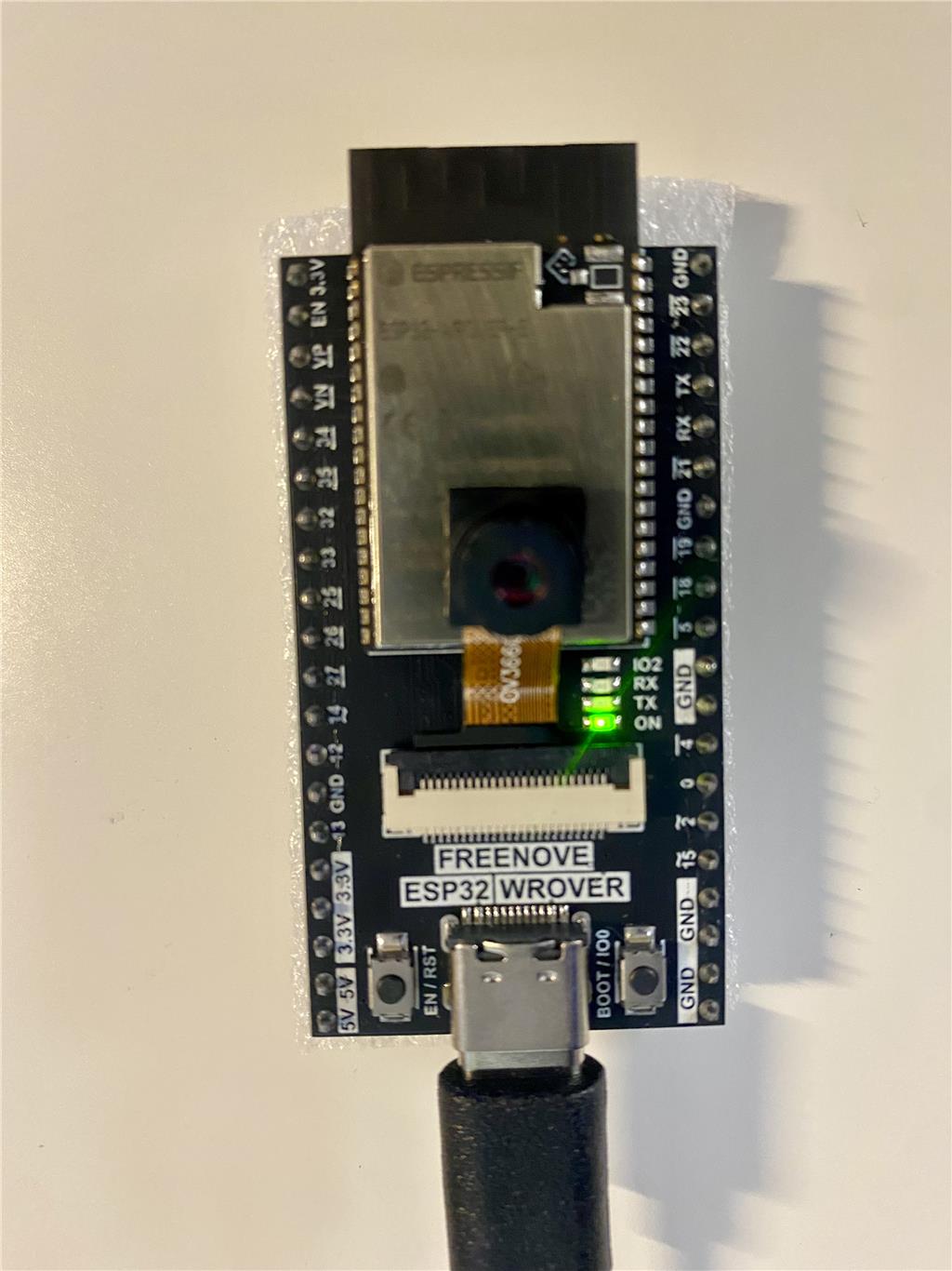

If you're only needing 5 servos - i say let's get a single pcb instead of two. i'm confident the esp32 cam could work - we just gotta make sure there's a version that makes sense. The kit that i have appears to work with all 5 servos and the camera doesn't stop. maybe yours is defective OR it's a different version? i'll post a pic of mine one minute...

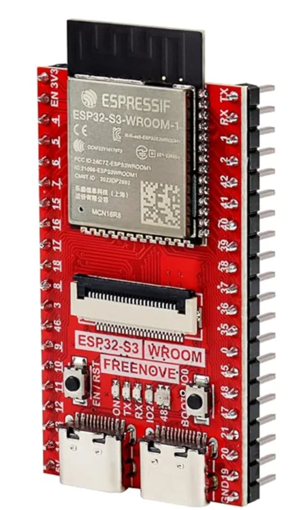

Yeah thats not the same mine, mine is S3 which is a different chipset. See at the beginning of this thread.
Same company different chipset. I think S3 is for somekinda security or?! I can order the one you have then we know it works let’s call that the " IO Tiny with cam replacement" . *** edit I ordered the exact same one as you no s3***

They can use 16 servos if there's no camera - don't forget that the camera requires several gpio pins. The gpio pins of the camera are defined in the camera_pins.h. That file is included in the firmware and all ESP32 demo code. You can look at that file to see the pins that the camera is using. Without the camera, the ESP32 should run 16 servos, but your application only needs 5.
If you have 2 ESP32s (one for the camera and one for the servos), how will they communicate with the PC? Will you have 2 Wi-Fi networks? It would be easiest to use an ESP32 Wrover that works with 5 servos and a camera simultaneously. The Wrover esp32 that I'm using appears to do that.

Not sure - depends on which pins and gpio are available, since the camera uses a lot of pins. You only need five servos, so it would be easiest to reduce hardware complexity by having just the esp32cam.
