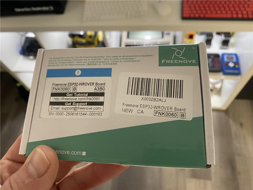

This came in the mail today. I’ll take a look at it this afternoon for ya.
#85
Awesome! That looks like the same one I got!
#86
I get 20-28 fps on that esp32 wrover with camera module with v9 of the esp32 cam ezb firmware. it was a huge rewrite but works good.
Moving servos doesn't affect the camera either. Works really good and fast

That’s amazing!!! Can’t wait to try it out!!! Thank you!

Nice just ordered one.  This maybe a great alternative to Iotiny we been looking for. I wonder how many GPIO’s work with the camera.
@athena can we get some specs on this Freenove ESP32-WROVER and what features we can use with ARC. How many servos can we connect at once without interfering with camera? Does Bluetooth work (speaker) can we connect microphone to I2S. Would love to be able to do TTS And STT with this back to AI as well as image recognition.
