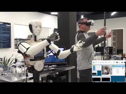

Use any servo or positioning system. And execute the ControlCommand in the Auto Position to create a frame and save the values.
here's an example: https://synthiam.com/Community/Robots/JD-Humanoid-Puppet-18061
here's an entire tutorial: https://synthiam.com/Community/Tutorials/Create-Auto-Position-Actions-from-EZ-Script-16353
here's a video
