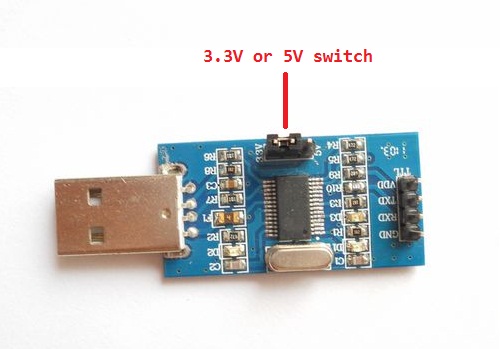

Set up the USB part like this
Connect the USB and the WiFi together like this
Connect the USB to the PC Open up the configuration program Select the COM port Click search
