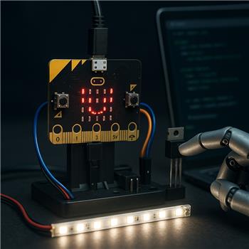

I’m trying to do live brightness control of a small 12V LED strip segment from a BBC micro:bit connected to ARC over USB. I flashed the micro:bit firmware for ARC, added the Micro:bit board, and I’m driving the strip through a logic-level N-MOSFET on P1 (common ground between the 12V supply and the micro:bit). I’m using the Slide Script skill with Min=0, Max=255, and the variable name set to $led_level. In the On Value Changed script I’m simply doing:
# Slide Script On Value Changed
$level = $led_level
PWM(P1, $level)
If I set a single value from the EZ-Script Console, like PWM(P1, 180), the brightness is steady and looks fine. But when I drag the Slide Script slider, I see noticeable flicker and sometimes lag (it feels like commands queue up). Also, when I originally tried P0, I got audible chirps from the built-in speaker and weird ghosting on the 5x5 LED matrix; moving to P1 mostly fixed that, but the flicker while sliding remains. I’m assuming the rapid On Value Changed callbacks are spamming PWM updates.
A few specifics I’m unsure about: is the PWM() range truly 0-255 for the micro:bit in ARC, or should I be using 0-100? Is there a way to change PWM frequency on the micro:bit via ARC to reduce visible flicker, or is it fixed by the firmware? And is there a recommended way to debounce/throttle the Slide Script output (e.g., only send when the change exceeds a threshold or every X ms) without writing a separate background script?
How can I throttle or debounce Slide Script updates and ensure I’m using the correct PWM command/range so the micro:bit on P1 drives the LED strip smoothly without flicker or interference from the LED matrix/speaker?

Yes - what you’re seeing is very likely slider spam, not a wiring issue.
Key points first
  • ARC PWM uses a 0-100 duty cycle range, not 0-255.
  • The Slide Script On Value Set Script can fire very quickly while you drag, which can cause visible flicker or lag if you send PWM on every tiny change.
  • On the micro:bit, some pins share functions with the 5x5 LED matrix and buttons, which is why P0 caused weird behavior. P1 is a much better choice.
  • ARC’s micro:bit firmware does not provide a user-accessible PWM frequency setting from the ARC PWM command. The PWM behavior is handled by the firmware/controller side.
Use the correct PWM range
If you’re using ARC’s PWM() / PWM.set() style control, the expected range is:
  • 0 to 100 = duty cycle percentage
So if your slider is currently set to 0-255, you should change it to 0-100 unless you intentionally want to scale it yourself.
