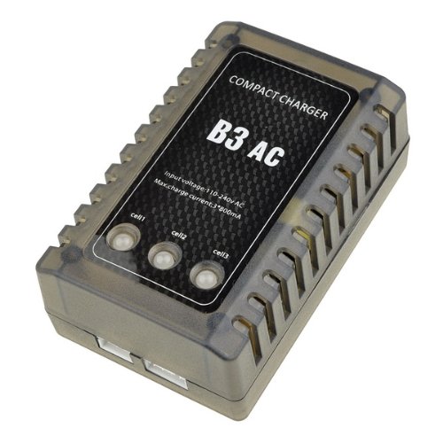

While you wait on EZ Robot to respond to your warranty request and If your in a hurry and have Amazon Prime here's one that may work with free two day shipping. It's only about $8 USD. Someone else needs to conform that the connections will adapt properly to Revolution Bots.
7.4 lipo balance battery charger
You could also try your local hobby store where they sell RC plains and cars or a Radio Shack.
#11
That on does have the right connections.
However, why do you think the charger doesn't work? (and if you posted already, sorry I missed it).
