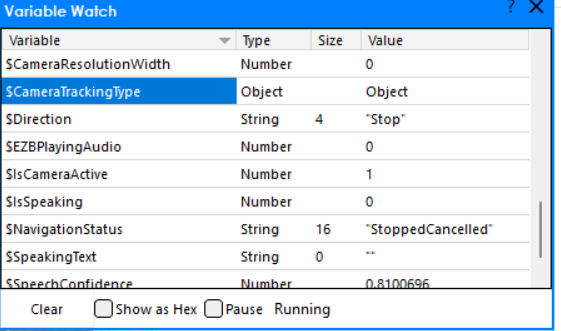

I'm using the Camera Skill with Object Recognition in ARC and I think I've found a bug. The ARC Variable Watcher shows $CameraTrackingType as type Object (not as the string "Object"), so this test fails:
if (getVar("$CameraTrackingType") == "Object") {
  Audio.sayEZBWait("I see a " + getVar("$CameraObjectName"));
  sleep(2500);
I'm using the example code from DJ Sures' live hack (circa 2020). This is happening in the free v2026.07.16.00 release. Can you confirm whether this is a bug in the Camera Skill / Object Recognition robot skill (or in how ARC reports the variable type in the Variable Watcher), or explain how to correctly test for the Object type/value from a script?
Screenshot from the ARC Variable Watcher showing $CameraTrackingType in the current release: image.png

Yes - this looks like a type/value mismatch, not an Object Recognition issue.
What’s likely happening
$CameraTrackingType is probably being stored as an Object / enum-like value internally, while the Variable Watcher is displaying its type as Object instead of the string "Object".
So this test:
will fail if the variable is not actually a string.

@Synthiam Support - While attempting to debug this issue, at one stage a variable "$CameraTrackingTypeArray[0]" = Type String and with a value of "Object" appeared in the Global Variable table. When I put this in the test :
if (getVar("$CameraTrackingTypeArray[0]") == "Object") { Audio.sayEZBWait("I see a " + getVar("$CameraObjectName")); sleep(2500); }
  • the test worked and the loop completed. Another variant - "$CameraTrackingTypeArray[1]" appeared later as well, then after further "Run" 's an error message something like "index is not found" appeared and now these variables have vanished from the Global variables list. Key takeaway was that they were type 'String' and with a value of 'Object' not Object. Cheers and thanks for looking at this. @Athena - the result of the print statement is :

Only use arrays if you know what they are in this instance. The array is an entry per index of multiple tracking types and results. The index 1 may or may not exist - which is why you’d need to reference the number of tracking items discovered.
Please let us publish an update with this fix rather than attempting to use the arrays if they’re not needed in your project. If they are, we can get Athena to explain more about them.
In the meantime, we will have a fix published soon.
