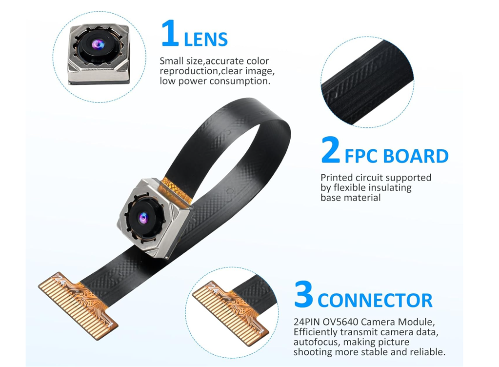

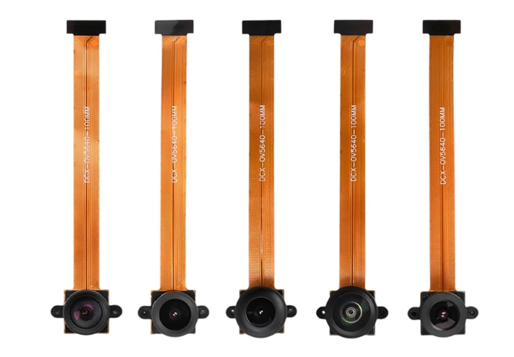

Cool I found packs of camera for esp 32 cam with different lenses. So cheap. I’ll grab and pack and do some tests. I think they go from 40 degrees to 120.
This is a nice step up camera its got 120 degree lens. $8.
