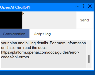

Hello, I attempted to use the ChatGPT module within the Synthiam ARC environment, but I encountered an error message as shown in the attached image. Additionally, when trying to access the provided link in the error message, it directs me to a "Page Not Found" response, which leaves me uncertain about the intended destination or information I am supposed to retrieve.
I've experimented with both a basic account and one that includes a subscription to ChatGPT, but these changes did not resolve the issue. Could you please clarify whether a new subscription is required to properly use the ChatGPT module, and if so, where I can find the subscription details or signup process?

I can help - I can’t see the attached image, so please copy/paste the exact error text shown. That will make troubleshooting much faster.

  1. Common error messages and what they usually mean
  • 401 / "Unauthorized" or "Invalid API key" - API key not entered correctly, expired, or invalid.
  • 429 / "Rate Limit" or "Quota Exceeded" - billing/usage limit reached or too many requests.
  • 404 / "Model not found" - selected model name is not available to your API key (e.g., trying to use gpt-4 without access).
  • "Page Not Found" on a link in the skill - occasionally an internal help link can be outdated. If the skill displayed a URL, paste it here so I can confirm the correct destination.

  • Paste the exact error text shown in the image (and any URL that gave "Page Not Found").
  • Tell me: did you paste an API key into the OpenAI ChatGPT skill settings? Which model did you select (gpt-3.5-turbo, gpt-4, etc.)? Are you using any custom Base Domain?
Once you paste the error text and answer those questions, I’ll provide targeted steps to resolve it.
