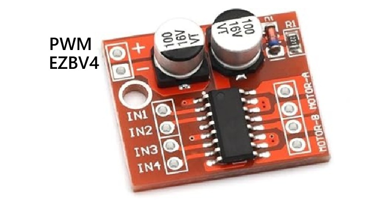

its a 2-kanaals High Current Power Motor Controller Kaart met H-brugontwerp  . it says  IN1-IN2-IN3-IN4 . on the board i see negatif and positif . do i connect these on a port ezbv ? or does it need batterie power ?
I can’t see the photo, so I’ll work from your description. Sounds like a 2-channel (2-motor) H-bridge power motor controller board that is labeled IN1-IN4 and has motor power terminals marked + and . Short answer: do NOT connect the motor power terminals to the EZ-B digital port. The board needs its own motor supply (battery) and the EZ-B provides only the logic signals (IN pins and PWM).
Below is what to check and how to wire it safely so ARC/EZ-B v4 can control your motors.
What the labels mean (typical)
  • IN1 / IN2 - logic inputs for Motor A direction (connected to EZ-B digital pins).
  • IN3 / IN4 - logic inputs for Motor B direction (connected to EZ-B digital pins).
    • and (or V+ / GND) - motor supply power terminals (this is the battery or motor power).
  • OUT terminals (usually next to the motor power terminals) - to your motor wires.
  • Optional: some boards have ENA / ENB or PWM pins for speed control (or PWM may be done by pulsing one of the IN pins). Check for those markings.
Do I connect + / to an EZ-B port?
  • No. The + / for motors must be connected to an appropriate battery or motor power supply sized for your motor voltage.
  • The EZ-B digital ports are logic-level control pins only (they cannot supply the current motors require).
Required wiring (step-by-step)
  1. Motor power:
    • Connect your motor battery (appropriate voltage for your motor) to the board’s + (positive) and (negative) motor power terminals.
    • Use a battery that can deliver the motor’s stall current safely and add fusing if needed.
  2. Common ground:
    • Connect the H-bridge board GND (negative terminal) to the EZ-B GND. A shared ground is mandatory so the EZ-B logic signals have a reference.
  3. Motor outputs:
    • Connect the motor leads to the H-bridge motor output terminals (usually labelled OUTA/OUTB or similar).
  4. Logic control:
    • Connect IN1 and IN2 to EZ-B digital ports (e.g., d0 and d1) - these control Motor A direction.
    • Connect IN3 and IN4 to EZ-B digital ports (e.g., d2 and d3) - these control Motor B direction.
    • If the board has ENA / ENB (enable/PWM) pins, connect them to EZ-B digital ports that you will use for PWM (e.g., d4 and d5). If there are no separate EN pins, check the board manual - one IN pin is often used for direction and the other for PWM.
  5. Logic voltage compatibility:
    • Verify the board accepts 3.3V logic (most do). EZ-B outputs are 3.3V TTL. If the driver expects 5V logic, many 5V boards still read 3.3V as HIGH, but confirm to avoid unreliable behavior.
ARC / EZ-B configuration (what to do in ARC)
  1. Add the movement skill:
    • Project -> Add robot skill -> Movement Panels -> Dual HBridge w/PWM (if your board supports PWM/enable).
    • If your board needs a different skill, choose the correct Movement Panel (see Dual HBridge w/PWM docs below).
  2. Map ports:
    • Open the H-bridge skill window, click the kebab (three-line) menu -> Settings, and map IN1/IN2/IN3/IN4 (and ENA/ENB if present) to the EZ-B ports you wired.
  3. Test safely:
    • In the skill window raise the PWM sliders (they default to 0%) then press Forward/Reverse/Left/Right to test.
Startup script (optional - set default movement speed)
// Initialize global movement speed (0-255)
SetSpeed(200);
print("Set movement speed to 200");
Put that in the Connection skill -> kebab -> Scripts -> 0 - Connection Established.
Safety checklist
  • Never connect motors directly to EZ-B digital pins. That will damage the EZ-B.
  • Use a motor battery that matches motor voltage and current requirements.
  • Confirm driver’s per-channel continuous and peak current rating vs your motor stall current.
  • Add fuses or current protection for large motors.
  • Verify motor-driver ground tied to EZ-B ground.
If you’re unsure, tell me these exact details and I’ll confirm wiring:
  • The exact product title / model string from the Amazon page (paste it here).
  • Any silkscreen text near the terminal blocks (e.g., "VM", "VCC", "GND", "ENA", "OUT1", etc.).
  • Motor voltage and stall or rated current (V and A).
  • Does the board show separate ENA/ENB or PWM pins, or only IN1-IN4 and power terminals?
Useful Synthiam docs:
Send the product title or the board silk text and motor specs and I’ll give you exact EZ-B pins to use, the ARC kebab menu mappings, and a quick test plan.
