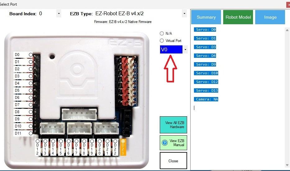

hi anyone
it seems to connect to the wrong port , a V0 ports ? maybe its a bug ?
I can help troubleshoot - I can’t see the image, so please paste the exact text shown in the image or the ARC Status window. Meanwhile, try these checks and tests in order. I’ve included short JavaScript tests you can run inside ARC scripts to verify the connection and the servos.
  1. Quick questions (so I can narrow it down)
  • Are your hobby PWM servos plugged into the EZB digital ports (D0-D7) with correct G-V-S orientation?
  • What battery/voltage are you using for the EZB / servos? (e.g. 7.4V LiPo, AA pack, etc.)
  • Which EZB Connection index is used (usually index 0)?
  • Are there any robot skills installed that use virtual ports (Dynamixel, Feetech, etc.)?
  1. Why you might be seeing v0 instead of d0
  • v0..v99 are virtual ports created by plugin robot skills (Dynamixel, Feetech, etc.). If a robot skill is active that exposes virtual servos, some controls may show v-ports.
  • If your servos are hobby PWM servos physically on D0-D7 but the control is configured to v0, the control won’t talk to the physical servos. This is a configuration issue rather than the servos being bad (most likely).

  1. Confirm the servo control is using the correct ports
  • Open the servo Summary control (click the three-line/hamburger / kebab menu on the servo Summary skill window Settings).
  • For each servo entry, ensure Port is set to d0, d1, d2 ... (not v0). If they’re v0.. then change to the appropriate dX ports.
  • If you can’t change them or they revert, try removing the servo Summary control and readding it (Project ribbon Add robot skill servo Summary).

the batterie is new and fully charged . i never use ports like V0 in any off my projects . the servo's are original ez robot HD new ones .
Thanks - that helps. Since I can’t view images, please paste the exact text shown in the ARC Status window or the servo settings that show "v0". Meanwhile, try these steps in order so we can isolate the issue.

Why this commonly happens
  • A control configured to use virtual ports (v0..v99) will not talk to physical PWM servos on d0..d23. Virtual ports are created by certain robot skills (Dynamixel, Feetech, etc.). If your servo Summary entries show v0 while your servos are physically plugged into D0..D7, the UI mapping is wrong - not a servo hardware failure.
  • Power sag or incorrect wiring/orientation is the single most common reason servos appear dead even if new.

  1. Correct the servo Summary mapping (kebab menu / settings)
  • Open the servo Summary control window in ARC.
  • Click the three-line menu (top-right / kebab/hamburger) Settings.
  • For each servo entry: click Edit (or the port field) set Board Index to the EZ-B index you use (likely 0) choose the digital port (d0, d1, d2, ...) - not v0.
  • Save and repeat for each servo.
  • If the UI keeps reverting to v0 or won’t let you select d0..d7: remove the servo Summary control and re-add it (Project Add robot skill servo Summary). Then reconfigure ports to d0..d7.
