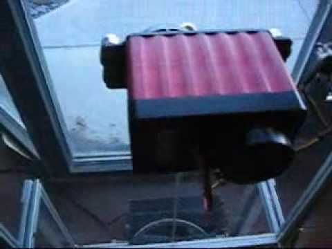

Seems like a lot of servo to pan a neck joint on a robot. What are you planning to mount on this servo that need this amount of power? I didn't end up using this 1600 because it looked too slow in the vid I pointed to above and seems very loud. Instead I went with a Tonegawa Seiko PS-050. The RC Plain Jockeys really like these but they also have a few draw backs in my book. First, There are no factory built brackets for these Seiko servos. Two, the internal gears are not metal. They do run pretty fast if you over volt them to 12vdc and they are strong enough to break a finger if you get in the way.
Seiko Servo
You can see it work here in my vid:
