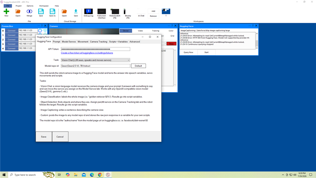

image.png The image above shows my settings, This is the default setting according to the provided info about this skill. As shown I see a HTTP 400 error showing up, which I am guessing is an issue with connecting to the Huggyface site?
Thanks for the screenshot - that helps.
What I see is that you’re on Vision Chat with the default Qwen/Qwen2.5-VL-7B-Instruct model, and ARC is successfully reaching Hugging Face. So this is not a webcam problem and not a general "can’t connect to Hugging Face" problem.

Not successful. I have tried all four of the models you recommended, none of them worked. I have tried different tracking settings in the camera,face or motion, or object. Again nothing is working.
Each time., I still get this message....
 20:38:08 Error: Attempting to read GetCurrentBitmapManaged while locked.
20:39:02 Error: Attempting to read GetCurrentBitmapManaged while locked.
20:39:42 Error: HTTP 400 from Hugging Face. {"error":{"message":"The requested model 'microsoft/Phi-3.5-vision-instruct' is not supported by any provider you have enabled.","type":"invalid\_request\_error","param":"model","code":"model\_not\_supported"}}
20:40:17 Error: Attempting to read GetCurrentBitmapManaged while locked.
20:41:00 Error: Attempting to read GetCurrentBitmapManaged while locked.
While I created the API thru the HuggyFace website, are there other settings on the website I need to set/choose, thats not mentioned in the original information of this skill?

Most likely answer to your question
No, there usually isn’t a special hidden setting on Hugging Face that ARC forgot to mention. The big issue is:
  • the model/provider combination you’re trying is not enabled on Hugging Face, and
  • ARC is also seeing a camera frame lock conflict
Next best step
Please try this exact diagnostic:
Clean camera test
  • Create a brand-new ARC project
  • Add only Camera Device
  • Start the webcam
Then add Hugging Face
  • Use Object Detection
  • Try the default model
  • Do not enable other camera/vision skills
If that works, then we know the camera lock issue was caused by another skill or setup.
If you want, I can help you with either of these next:
  1. a known-good ARC camera + Hugging Face test setup
  2. a face-tracking setup using the Camera Device skill with pan/tilt
  3. checking your Hugging Face token / provider settings step-by-step
If you’d like, send a screenshot of:
  • the Hugging Face skill settings
  • the Camera Device skill
  • and your Hugging Face token/settings page with sensitive info hidden
and I’ll help you narrow it down.
Yes, I would like a step by step of these three items......
