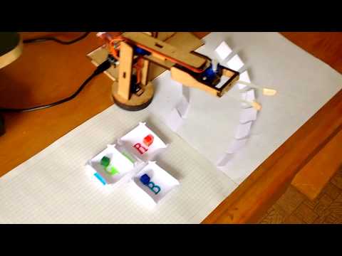

You sure can. That video is faking the sorting of colors because there is no camera or color sensor. Instead, that video is merely an Arduino moving servo through a pre-programmed routine. With Synthiam ARC, you can reproduce that video more efficiently by using the same configuration with an Arduino EZB Firmware.
I am not sure this is the case as he throws the blocks down and does not place them down.  I assume he has an over head camera (perhaps the one we are watching the video from but more likely directly above where he is throwing the blocks).  He is using the paper pieces to align the robot arm.
For this skill we will need to use colour detection in ARC and not auto position.
Check for blue if blue exists  get coordinates of object from video feed. Move robot arm to coordinates.
do the same for other colours.
we don’t need the paper alignment though and we can throw the blocks anywhere in the room and attach robot arm to a vehicle.
Interesting video. I just watched it based on these comments and there probably is a camera. No one can see it but it must be overhead. Strange they didn’t show it so I can see how that could be confusing.
i disagree about the Auto Position though - you’d still need it. Because once you have the object picked up, the Auto Position will place it in the appropriate cup for the color. So have 3 actions, for dropping in red, blue or green cups.
it doesn’t matter the starting position when using Auto Position actions. Because the transition would start from where ever the servos are.
so the easiest way to do this shouldn’t take much longer than half an hour.
  1. mount an overhead camera
  2. determine the x/y servo position relation to the screen coordinates. Meaning pixel 10,10 is servo 30, 60 (or what ever). That way, when a object is detected at an x/y coordinate, a simple servo command can send the arm to get it
  3. once the arm has the block, have a IF condition that launches the respect Auto Position action to place it in the appropriate cup
  4. keep the arm out of the way until another object is detected.
  5. repeat:)
Far too easy haha
