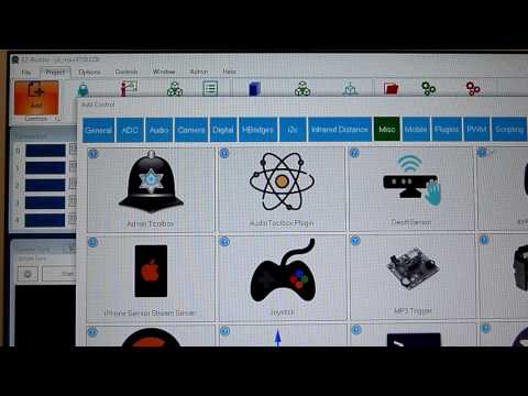

Hello everyone.
Fixing last bugs:
Feedback/Ideas are welcome.
PTP,
Internet is down at the house. I will check this out when it comes back up.
You, my friend, are the MAN! Awesome plugin!
The only thing that I can see that would be nice is if there were a way to see a list of everything that is locked or hidden. Not necessary, just a nice to have.
Thank you PTP and well done.
