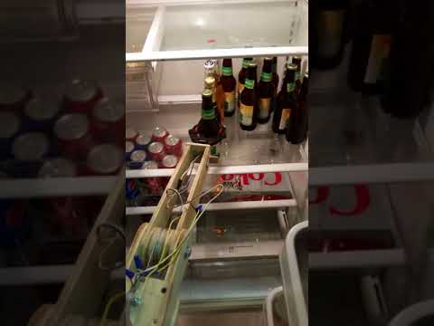

I look forward to sharing more on this forum. I have made a lot of progress with Sabertooth and kangaroo control and speed ramping. I have the next 5 months with no work, so I am excited to make a lot of progress with DudeBot, and share what I learn. Here is a crude video from last year of him autonomously fetching his first beer.
Sorry its so long
The most useful robot I have ever seen.....

Hahaha can I have one of those robots please?!
:D That is the coolest robot ever,get a beer get a beer get.....perfect for the Saturday man-cave! Me likey alot!
