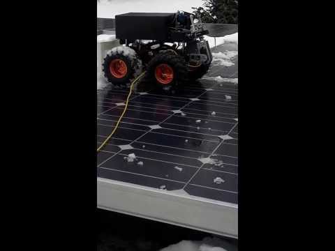

Made this attempt with Thumper today. Snow plow was a 3D printed part using Makerbot.
Thumper does not have the power or the traction even though I have 2 1500 watt batteries in parallel.
This is the flattest of 3 solar arrays, the others it would not work at all.
Any suggestions.

Increase the voltage to the motors but use PWM to limit the speed, the traction should increase. Use better tyres for more grip too, there's no point in increasing torque if you can't transfer the power from the motor to the surface you are driving on. Believe it or not, weight distribution can play a huge part in helping get the power down.

No the batteries are 1500 watts each in parallel. Panels are 225 Sharps. I have 43 on roofs.
I may try the tractor base I have.
It is snowing now here in NJ and I tried again and he slide almost off the roof.

Tried different setting with PWM.. no success... the biggest problem is the traction.

Were talking batteries not solar panels now, right? Batteries would be measured in amps not watts.... 1500 watts would be around 125ah battery .... assuming we are talking about a 12v battery

Throw some decent tyres on that thing and improve grip. Distribute the weight over the drive wheels to get the power to transfer from motor to surface. You could increase the torque but if it can't get the power down it'll sit there spinning it's wheels. If it already spins it's wheels start with weight distribution and tyres. If it doesn't then increase the torque with either better motors or more volts.

@jackphillips1953 in this case speed and batteries are not the prime factors. The tractor base will provide better traction. I have both a rover 5 track base and the wild Thumper base, the Thumper base exceed in rough terrain travel with speed and awesome chassis. The rover 5 chassis exceed in rough terrain hill climb, awesome traction's. I say give the tractor chassis a goes:) .
