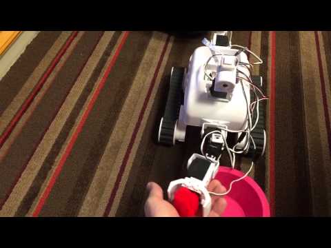

As for new ideas for courses - one of the future uses of robotics will be remote presence. This means controlling a robot from afar. Perhaps the robot is on Mars while you are on earth. Now, you only can see what is in the camera. You're not able to actually see the robot! Put the robot in a separate room or have the students controlling it turn their back to the robot.
Here is a video example of one of the exercises - the robot is modified to "pick up cotton balls" and place them into their respective matching colored bowls. The robot is controlled by a joystick - but can also be autonomous.
It is possible to program the robot to automatically pick up a color and place it in the respective bowl - one step at a time:)
