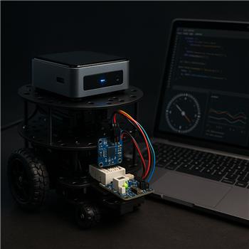

Running ARC on a Windows NUC mounted to a TurtleBot3 Burger. OpenCR is on USB for drive, and I added an EZ-B v4 over Wi-Fi just to handle I2C. I wired an external MPU-9150 breakout to the EZ-B v4 I2C port (SDA/SCL/GND, powered from a 3.3 V buck). The I2C Scan control sees the device at 0x68 and wiring looks clean on a scope. Added the "MPU9150 Accelerometer, Gyro, Temperature, Compass" skill, clicked Init, and I can get a single read with RunOnce; Variable Watcher shows compass and gyro values updating. Goal is to fuse yaw into my ARC JavaScript heading hold script for the TurtleBot3.
The issue is continuous polling. I’m calling RunOnce every 100 ms from a JavaScript control like this:
ControlCommand("MPU9150", "RunOnce");
var yaw = GetVariable("$imuCompass");
If I loop that at 10 Hz, after ~15-20 seconds ARC’s ping to the EZ-B v4 spikes and the IMU variables stop changing until I stop the loop. Dropping to 2 Hz helps but it still eventually stalls. Manually pressing RunOnce every few seconds is always fine. Wi-Fi RSSI is steady, CPU on the NUC is low, and other controls are idle. I’ve tried moving the loop to a separate Script control, checked for duplicate ControlCommand calls, and confirmed the I2C address/pull-ups; behavior is the same.
Is there a recommended polling pattern or configuration to get stable, continuous readings from the MPU9150 skill on an EZ-B v4 with ARC on a TurtleBot3, or should I instead plan to read the TurtleBot3’s OpenCR IMU over USB via a custom plugin or serial bridge?
