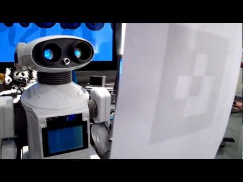

You may be able to abuse the Glyph Recognition system. Just make arrows and assign commands such as (These are very paraphrased btw): Glyph1 = up arrow, Glyph2 = down arrow, Glyph3 = right arrow, Glyph4 = left arrow.
On Recognize Glyph1 move forward. On Recognize Glyph3 turn right then move forward.
You could put arrows on the ground and have your camera looking at the floor.
You can even make glyphs that symbolize rooms. You might be able to make a script like (once again not real code) GoTo(MyRoom) ControlCommand (Start glyph tracking) #This will start him moving On Glyph Detect (Living room) Stop
I'm sure there is an Example Project that will show how to assign values to recognize the glyphs. I haven't messed with them at all so I'm going off of theory on this.
These are just core ideas and need a little more code to them than I have eluded too but I think it's very doable. I have been know to make mistakes. From time to time.
And just so you don't have to go digging for the Glyph Video. In this video the glyphs are triggering a speak command. i don't see why you can't change it to any command you want.
