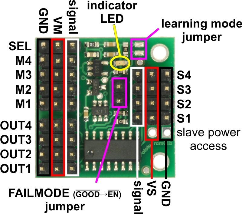

#48
DJ,
This is the pololu r/c multiplexer switcher device, it is designed for you to control up to 4 servos between either of  two separate R/C receivers ( or two EZB's even). I've used this product before.
I am only using two channels, the two HB25 M/C are connected to Out 1 and Out 2. S1 and S2 are connected to my EZB (D12,D13 for Automatic Mode) and M1 and M2 are are connected to channels 1 and 2 on a 2.4 R/C receiver (for manual Mode). Channel 5 on the receiver connects to  the SEL pin, and is "Y"connected to a pololu pwm/digital output pin that goes "High" to D22 of the EZB on this project. on the R/C transmitter, flipping Ch5  switch allows me to disconnect drive motors from the EZB i/o pins and switch over to the R/C receiver to control the motors manually. Its not something I will always use but I want the choice and it will be the only r/c controlled feature on this robot. To power this board, I get that from the R/C receiver via the VS pins and I am not connecting this power to any EZB pins or m/c pins. The m/c is powered separately. So my R/c receiver is not directly connected and EZB  I/O pins. I am aware i could use a relay to switch between the two but I found this alot cleaner solution for me and I wanted a way to tell ARC whats going on.
Athena On the JC code we have been working on, I see a "Servo. release()" in that last relay script you created, Would that be helpful on the other script? just a thought??
