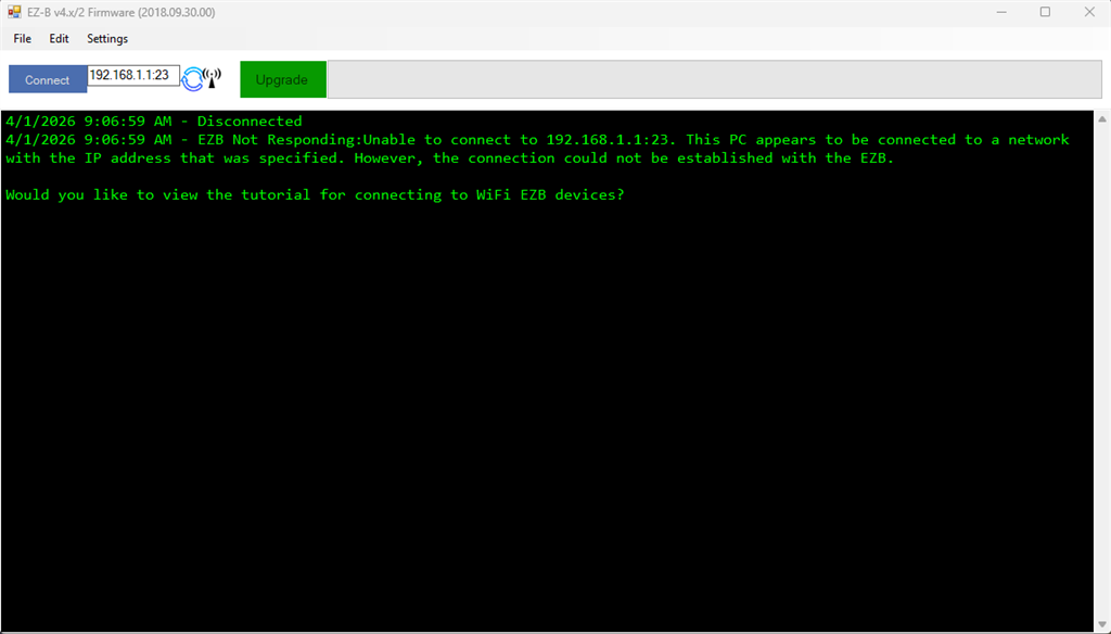

Has anything changed with the EZ-Bv4 firmware updater recently?
I'm experiencing an issue where, upon connecting the firmware updater to an EZ-Bv4, it immediately disconnects, preventing me from updating the firmware.
I've tried using both the previous and the most up-to-date versions of ARC. Additionally, I've tested this on two different networks (home and office) and on both Windows 10 and 11. I've also attempted to update multiple EZ-Bv4.x/2 controllers, but each time the same result occurs-the connection is established briefly with the EZ-Bv4 connected sound, and then it immediately disconnects with the corresponding sound.
Thank you for any assistance you can provide.

I am connecting via WiFi AP mode. I am using a stable battery power source. Yes, both EZ-Bv4 controllers I have used connect to ARC and the cameras are operational. Start up sounds normal. The webserver is accessible on both controllers.
Here is the diagnostic text for the firmware updater:
Quote:
4/1/2026 5:46:42 PM - Disconnected 4/1/2026 5:46:42 PM - EZB Not Responding:Unable to connect to 192.168.1.1:23. This PC appears to be connected to a network with the IP address that was specified. However, the connection could not be established with the EZB.
I cannot connect via USB/COM mode, in fact that's my original issue. I am troubleshooting the USB/COM connection. I cannot connect via USB/COM to the EZ-Bv4 to ARC connection skill, neither can I connect the camera to using a COM port through the camera skill, as I previously have been able to. I then went back to the beginning and tired updating the EZ-Bv4.x/2 firmware and could not do that either.
I know there has been some changes to the way EZ-B controllers connect to ARC, has this disrupted the original functionality?

#4   — Edited
I've never used Powershell, here's goes nothing:
I used your prompt:
Quote:
Test-NetConnection -ComputerName 192.168.1.1 -Port 23
PowerShell attempted to connect, I heard the EZ-Bv4 connection established sound and then immediately the disconnect sound played: This text was displayed:
Quote:
Test-NetConnection - 192.168.1.1:23 Attempting TCP connect
Waiting for response
and then a little while later the following text was displayed in PowerShell:
Quote:
ComputerName : 192.168.1.1
RemoteAddress : 192.168.1.1
RemotePort : 23
InterfaceAlias : Wi-Fi 3
SourceAddress : 192.168.1.2
TcpTestSucceeded : True
As for the USB/COM port, I have tried 3 different USB-TTL devices that support over 3.3Mbaud and they all show up in the Device manager as successfully installed COM Ports 9, 10, and 11. I have tried many different pin connections, swapping TX and RX, using and not using RTS and CTS.

I could only get your commands to work when I connected to ARC
First output:
Quote:
TCP 192.168.1.2:56701 192.168.1.1:23 ESTABLISHED 26268
Second output:
Quote:
Image Name PID Session Name Session# Mem Usage ========================= ======== ================ =========== ============ ARC.exe 26268 Console 1 349,896 K
Here's the log from the Connection Diagnostic in ARC, when connecting the EZ-B to ARC:

The Connection Diagnostic did not update when trying to connect to the EZ-Bv4 in the firmware updater.
By the way the "Copy Log to clipboard" button does not seem to work for me with the latest version of ARC and Windows 11. I did not seem to copy to the clipboard because when I went to paste the previous copied text was pasted. I had to manually select, copy, and paste the log.
I also tried turning off Windows defender Firewall and then connecting in the firmware updater again, the same result happened. The connect sound was made immediately followed by the disconnect sound and message.
Trying to connect via Telnet, here's the message:
Quote:
Error #1002: You do not appear to be a valid ARC instance. Closing Connection!
Connection to host lost.
The same result happened. The connect sound was made immediately followed by the disconnect sound.

I completely rebooted my computer so that no other program was connected to the EZ-Bv4, I connected to the EZ-Bv4 WiFi SSID, loaded the firmware updater and tried to connect again. The same result was found again, connect then immediate disconnect.
I really think there's been a change to the firmware updater source code during the last few ARC updates. It has never been this difficult to connect to the firmware updater.
Telnet on port 8080 works to communicate with the EZ-Bv4, do you think that the firmware updater is supposed to use port 8080 and somehow the code has been changed to use another port?
