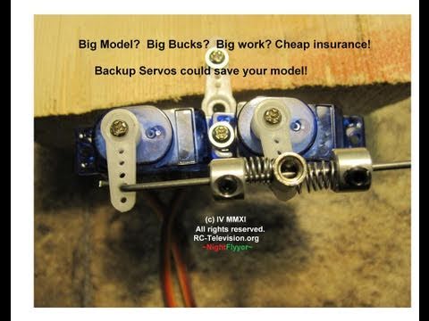

Here's a good YouTube vid where a guy shows two ways to tie two small servos together. The second example uses a type of "clutch" using stops and springs.

Hey guys i have been on vacation and my ear was itching so i logged in.;) yes double servos or more commonly called Tandem servos are a regular practice. There are some dos and dont's to follow here. A double servo is also the suggestion i made to Ant as well and he is now using them for lexis elbows.
Do-
  • Only use the same model servos! I cannot stress that enough.
  • try any use servos know for their power , here are some examples. Your budget will likely be your limitation. -hobbico cs170 $90 over 400 oz in @ 7.4 -power hd 1500mg $20 240 oz in @ 6v -hitec 645mg $20 133 oz in @ 6v
  • in a tandem setup you can either use script or a tandem servo controller from futuba. This makes one servo move in the exact opposite rotation from the other servo.
Do test your setup to ensure they are moving in unison and the servos are moving to the same but opposite rotation position. Once you are sure of positioning you can move to testing completely assembled.
Donts -
  • Dont even try mixing two different servos. Because of variations in position control , response time of the servos driver and the accuracy signal interpretation you are setting yourself up for failure to mix them.
  • Dont order any knockoff / clone or china servos if you can afford otherwise due to quality control in some cases. ( most servos are made in China anyways but it has to due with the quality control of the dealer channel you get them through) If you get unbranded or tower pro 995 servos then at least use two servos that were bought at the same time so they are most likely to have the same quality.
Dont hook up two servos in tandem setup with any stiff or hard linkage when you first assemble them and test. If the servos are off by more than 1.2 degrees ( i believe thats the number) they will burn up within the first couple min.
