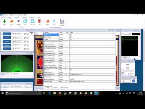

Sure. Here's a screen grab with the variable watcher added...
and another of the AIML code I'm using that kicks out the error (can't put it in code tags as it won't format properly)...
Like I said, it's weird that most of the other AIML codes work without the error, just the "what is your name" one and a couple of others which I can't remember which. This one works fine with no errors and brings up the popup display...
It's formatted exactly the same as the "ask name" one. Here's the script I'm using in the Pandora response script (also in post #1)
ControlCommand("Display Popup", Display, "" +$pandoraResponse)
Have I formatted that ControlCommand correctly? If you need anything else, give us a shout.
