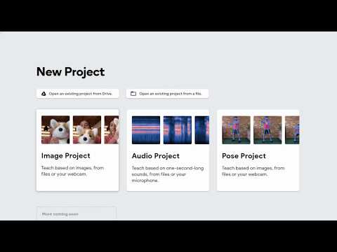

Quote:
https://teachablemachine.withgoogle.com/
Works with ARC...:)
