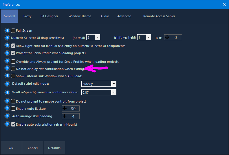

I think there’s an option in preferences to disable close dialog. Want to disable that too.

4) Check the ARC exit confirmation setting
You already found the relevant setting:
  • Preferences
  • Disable Do not display exit confirmation when exiting
    or, if the wording is the inverse in your version, make sure ARC is allowed to close without prompting.
If Windows is still asking whether to end ARC, that means ARC didn’t exit cleanly enough before shutdown.

From top menu -> Options -> Preferences -> Do not display exit confirmation (make sure that's checked)
@DJ and @Athena , thanks for the help. I appreciate your personal care and taking the time to answer with your welcomed suggestions.
Actually in my first post I did mention I had already checked the "Do not display exit confirmation" in ARC's Option/Preferences section with no results.
