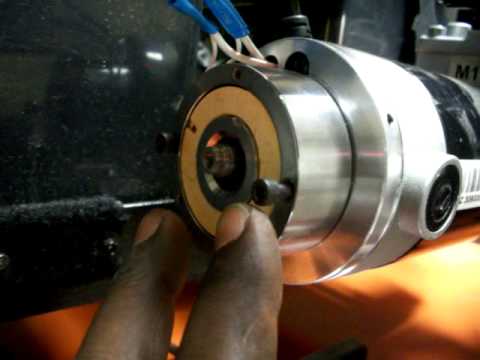

first, you have to open up the 24 volt motors and disengage the brake. they are naturally engaged when no power is on them, until 24 volt is applied to release it. if you do not take the breaks off, you can burn up the breaks, smells like fish (not that i would know...) it will also make the motors burn up or cause them to draw more current which could start fires or burn up the motor controller.

ok now, while those items are being shipped to you, you need to take the 24 volt motors apart and disengage the brakes. unscrew the 2 black screws on your wheelchair motors. (this only works if you have a joystick controlled wheelchair that is zero turn radious because the scooter type with handlebars have a differential gear system and only has 1 motor.) now when you take the black cap off of the end of the motor, cut the small wire. then using a hex key or alan wrench, and pliers, take off the center nut, you may have to take off some of the other hex screws around the edges. be careful it may be spring loaded. next put the cap back on, you successfully disengaged the brakes! watch this other guy's video on disengaging the brakes...
