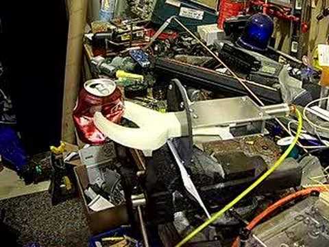

Here's a video of a set of claws used on the end of B9's arms operated by pneumatics. Very cool. If you listen you can hear the hiss in the background.
It would be very eazy to interface EZB with a system like this.
Have fun, Dave Schulpius
@Dave ...funny video:) I also toyed with the idea of pneumatics (air muscles) but for the same reasons of compressor noise and hiss, declined....but ...that being said ..the sound of hissing might be a coool addition!
This is pretty cool video...the hissing could be a nice effect.:D
