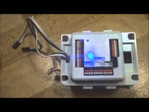

The noice is quite nerve-racking for me. Its not too loud, but it's the kind of noice that you cant bear for long.
Here is a video in which you can hear the noise.
Yeah, that sound is not normal. Please contact our customer Support for a warranty replacement.
