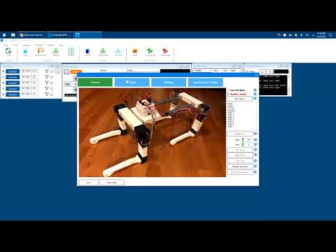

  1. I see you're using the generic speech recognition control. What variable were you expecting to see?
  2. The Auto Position is not an Auto Position Movement Panel, so there's no way any other control knows how to instruct it to move - this might be what you were expecting?
I made a little video that might help? Hope so anyway:D

Dave - you can still have as many Auto Position controls for different parts of your robot following the standard ARC procedure that I outlined above. That procedure being "Using a Movement Panel to handle moving the robot". And by moving, i mean physical location movement of the robot (i.e. how the robot moves Forward, Left Right Stop, etc). If you don't use a movement panel, then you miss out on a huge benefits of the software. Such as the camera tracking, joysticks, wiimote, default speech recognition commands, and more...
The Auto Position control I used in the video is a Movement Panel. Again, it registers itself as a Movement Panel throughout the software so all controls know how to make the robot move with simple commands like Forward() or Reverse() or Stop()
A movement control is how your robot moves. Your robot can only move with one method of locomotion and THAT is the movement panel.
Now even though you have an Auto Position movement panel, there’s nothing stopping you from adding a hundred regular Auto Position panels.
And, you can chain them together with ControlCommand(), if you needed to.
But David, in your application you would NOT use an Auto Position Movement Panel because your robot moves through a different means of locomotion. In your case, David, you would use an HBridge or Sabertooth movement panel. (I'm guessing that you use one of those two physical locomotion methods)
