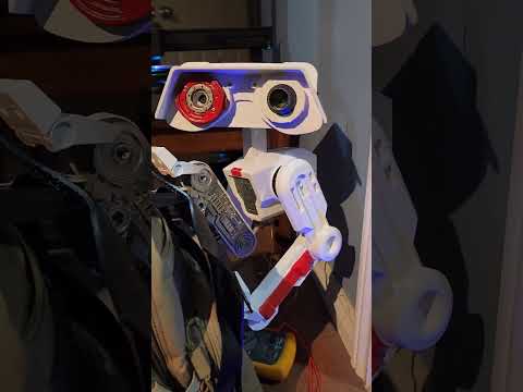

My setup is using a esp32 Cam. It's connected to ARC via wifi. I have an IO-tiny as well. Current setup has the esp32 running AP mode and both SBC and IO-tiny connect to it.
I've got the robot tracking but I'm looking on any advice on how potentially I could improve things. I've searched and found the initial setup videos got me to where I am now but I'm unsure on where I could look to make improvements.
First a video of how its reacting.
My setup is as follows
Camera is set to 160,120 I've found that setting this to 320,240 I have a hard time trying to find settings that work well. Is this because it buts to much work on the processor?
Face detection options that are working.
Min 26 pixels Max 120 pixels Min detection Cnt 2
I came to this by trial and error, my understanding is reducing the Min increases CPU usage. But if I increase I very quickly lose detection, and reducing below 25 seems to have the same effect?
I noticed with this setup my FPS is pretty steady at 11. Not sure how this factors in. Should I be looking to achieve a higher FPS?
Movement settings I found that initially the head would move too fast, I reviewed the advanced settings and made the following changes
Increment steps 3 Velocity 1 Speed 1 Acceleration 0
I'd like to try and improve things if I can but I'm not sure what's my limiting factor here, wifi connection, camera my understanding of the settings.
Any advice welcome.

The max setting determines how big to stop looking for a face. So you’ll have to consider how big your face is within the image. So if your face is half the resolution, it’ll be fine. But if your face is closer than the value needs to be higher.
Oh also lighting is important. I was just thinking that I forgot to mention it
Thanks DJ
Can the FPS be used as a benchmark for how the settings effecting the processor?
When I get back home I'm going to look at some object training for BD-1 but I'm also thinking of adding this capability to chopper. I can add a usb Camera in that case but I'm not sure what kind of resolution I need.
The fps will lower if the tracking type is using a lot of cpu. Each frame may take longer to process and that will lower the frame rate. That won’t affect the tracking accuracy though.
