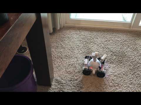

In searching for a noise tolerant microphone for my EZ-Robot AdventureBot I checked out the Amazon Echo product which has a great feature in its always-on array microphones. You can even place several low-cost Echo Dots ($50) around your home to enable multi room use. The problem was how to get it to talk to EZB.
The answer is, as pointed out by @Mickey666Maus in a previous post, the free web service called IFTTT (If This This Than That). IFTTT has a built-in interface (Channel) that supports Amazon Echo and includes a user defined Channel called Maker that offers a means to send http commands to devices.
  1. Add an HTTP server control and start it in ARC. In my case I used port 8010.
  2. Add port forwarding in your router to direct this port to your PC that is running ARC
  3. Create scripts in Script Manager to perform tasks; e.g. forward, stop, reverse, battery level
  4. Create Applets in IFTTT to trigger (the IF part) from Amazon Alexa Channel to invoke actions (the THEN part) in the Maker Webhooks Channel to launch the scripts in ARC.
  5. Test the applets by speaking to the Amazon Echo and watch the EZB robot respond
In practice, this gives a neat way to have a walk around "remote microphone" to control your EZB robot or even just perform a simple verbal battery level check.
If desired, you could even add the $30 "Amazon Voice Remote for Amazon Echo and Echo Dot" to have a handheld microphone
If there’s enough interest in this, I could write up a tutorial with detailed instructions
