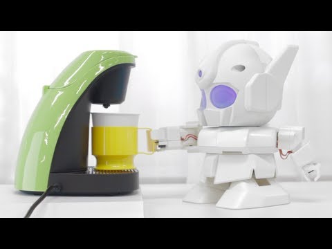

There is a lot that I dont like about this bot, but there is a lot that I like about the head of this bot. The school's mascot is the patriots. This head, with the ears will look good for this project because it can be painted to look similar to the logo (like the NE Patriots NFL team logo).
here the original video.
